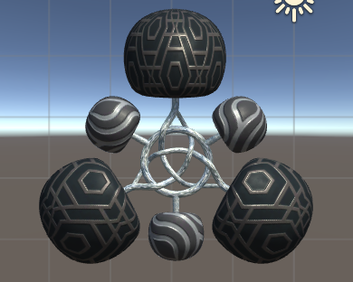

Awesome thanks Alex, I wasn’t expecting it to match the same standards, I
just wanted to see what if it could even work and get to grips with the
procedure.
There’s the file in .fbx, it has a couple of un-necessary layers i.e.
subdivision_surface, inbetweens, rods and outermost outline, and would look
more like the attached picture in the end hopefully.On 24 July 2015 at 14:52, Alexander Lang alexanderlang1980@gmail.com wrote:

Rich,
To print a piece like that in one go is not possible IMO. I would print
the centre structure- the celtic knot with struts first. Although I would
actually print it in two halves and then glue those together. I would then
print the erm…ball sections again in two halves and then glue those
together and then stick the balls on the struts…and hopefully - Job Done.
I would get the opinion of some of the others though just in case I’ve
missed something.

OK that’s a great idea, when you say print the middle in two halves, i’m
now thinking something completely different…
Could it possibly work better making a mould and doing casts? Is actually a
dream of mine! Plus 3D printers take a while!!
“To print a piece like that in one go is not possible IMO.” -
Damn I thought this is where 3D printers would excel at, printing
impossible things!! In regards to 3D printing two halves of the Celtic knot
down which axis would you split?On 24 July 2015 at 15:19, Alexander Lang alexanderlang1980@gmail.com wrote:

That shape will be fine to print in one go on a sintering machine like
Shapeways have. I’ve had a few things printed there - where did the
3mm restriction come from? I can’t see it on the website for the white
strong & flexible material.
The main question I think would be how thick the ‘rope’ used for the
knot is - do you know the diameter?On 24 July 2015 at 15:42, rich op richop88@gmail.com wrote:
procedure.
impossible
things!! In regards to 3D printing two halves of the Celtic knot down
which
Rich,
would
then
Done.

I should clarify my answers related to using the 3D printer in the
hackspace and not shapeways…

I think the relevant restriction would be the “wire thickness”, which
is 1mm for a model of your size if I’m reading it correctly. Trouble
with Shapeways is it’s expensive to make a mistake - you might want to
upload it to them and get them to check it for you.
I’m thinking if it was 1mm for the wires it might not have much structural
integrity and potentially the heads could just snap off. And indeed
expensive to make a mistake! Thank you so much for your input both of you!

https://lh3.googleusercontent.com/-NMuCQ8z5YkU/VexVV4BDV9I/AAAAAAAAAD8/q4WH_CyOQ7U/s1600/11950283_10153658265031742_5181295897335862379_o.jpg
OK, so I think I have the model ready for 3D printing, I’ve gone over the 1
million polygon limit for shapeways, is there any restriction on file size
or polygon limit for the goo printer?
