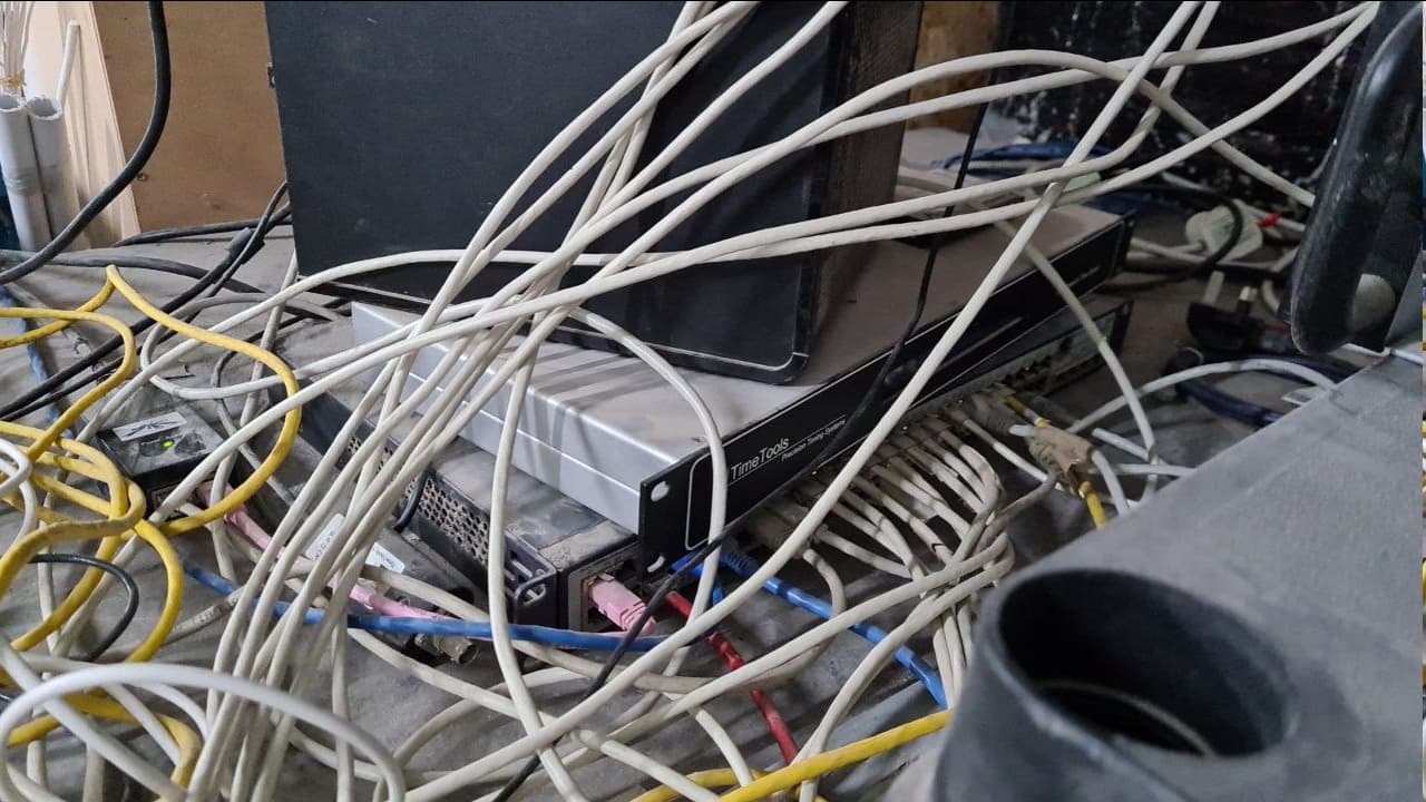

The servers have been cleared out of it, currently 2 HP network switches are sitting inside
For now I’ve put a DNH sticker on it, although I may remove that if we’re getting rid of it.

Currently there’s 1 in use on the bar, I’m not sure of the model of this one
We also have one spare one on the bar (a d-link) and 2 spare in the big rack (HP ones)
I think the current plan may be to scatter the additional switches around the different areas (such as visual arts)
instead of having everything in the one rack.
So I suspect we may only need 1U total for this if we have the other switches scattered about.
I’m not sure if the D-Link is better than the HP in terms of throughput / managed features etc (Usually I just deal with cisco)

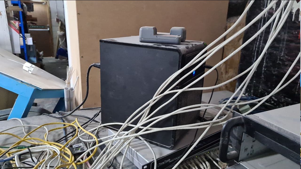

HP Mini Server
There is a small HP Mini Server, this isn’t in a rack format / rack mountable so takes up a fair bit of space since it’s cube shaped.
Approx 27cm High, 22cm Wide, 25cm Deep
I remember we had a conversation upstairs about lack of space inside the old rack
I’m not quite sure what it’s used for at the moment (door access? or something else?)
Questions on this one would be
  • Do we know all the different things it’s used for?
  • In order to reduce Power / space would it be worth considering replacing it with a Pi4 with a couple of hard disks attached?
Because of it’s shape I think it’s height would take up around 6U, so at a guess it wouldn’t fit into the new small rack.
For the old small rack it’d leave just 3U spare.

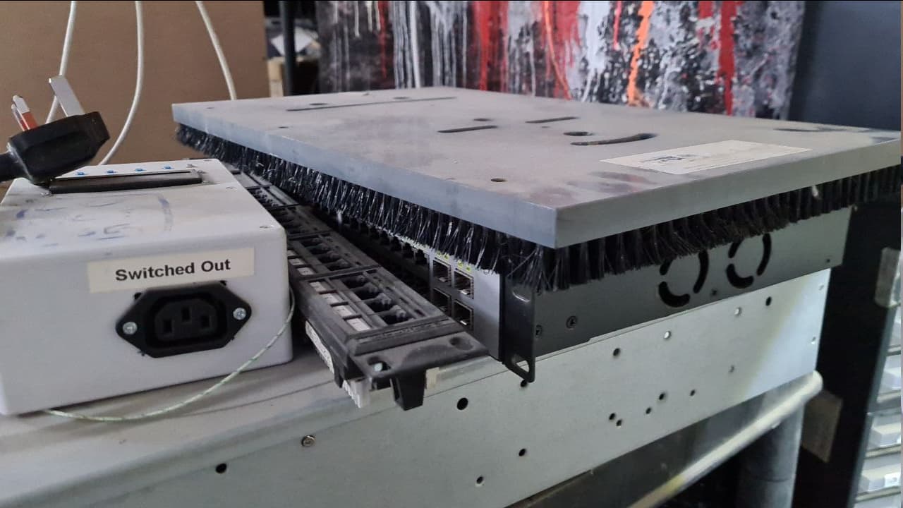

Time Server
This is something I brought in ages ago, it’s basically a radio receiver based NTP server
We don’t really need it but it’s a nice to have / nice to hack with in terms of getting a high stratum of time.
Currently this would take up 1U of space if fitted.
I think it’s a small embedded device so takes up little power.

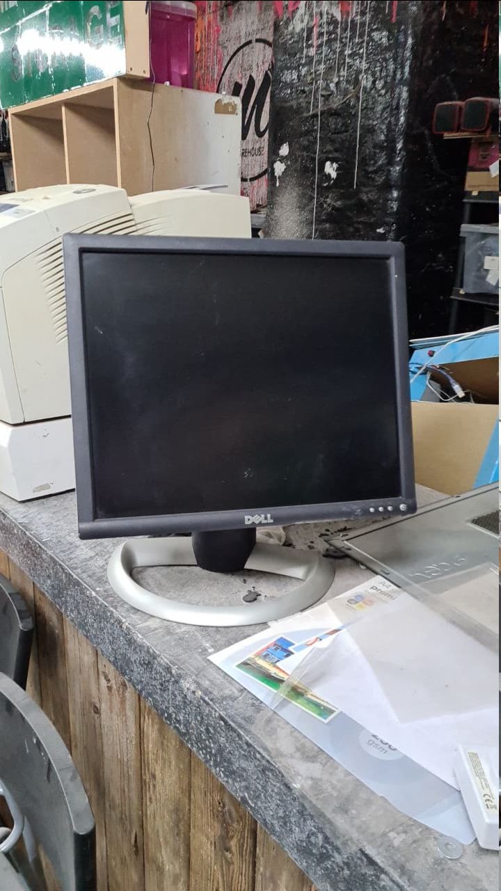

  • Monitor with keyboard near the top
    For the monitor this is approx 43cm High, 38cm Wide, 25cm Deep

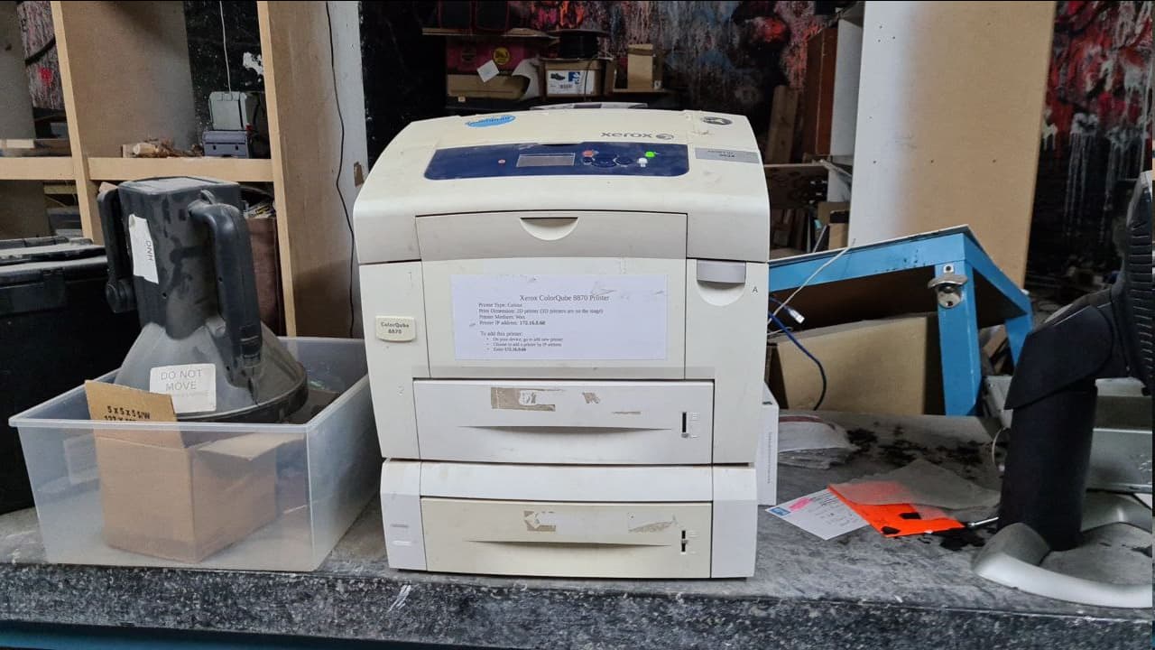

  • Printer - maybe see if we can shoe horn in the printer to get it out of the way?
    Approx - 55cm High, 40cm Wide, 55cm Deep

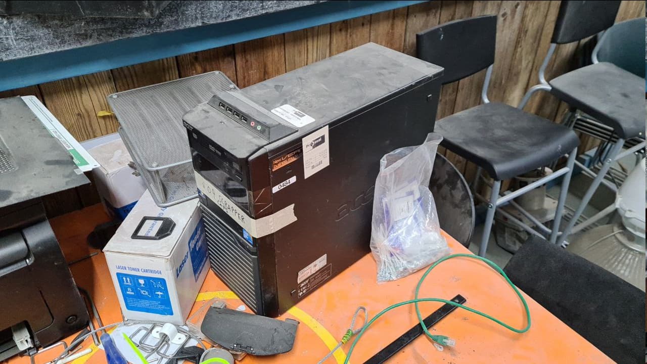

  • 2 x PC Tower cases, Approx 36cm High, 18cm Wide, 48cm Deep
    There’s currently 2 PC tower cases sitting on the front, I’m not sure of the state of them
    The only use for them might be the usb scope software since that might be mostly windows.

If Bob is now bringing in a 5U rack then that can take the place of the 9U rack. I’m also on for turning off the microserver given it currently just acts as a slightly rubbish fan heater.
We need SSH access to the space which is the only thing the microserver is being used for I think. I’m fairly sure this can be sorted with a Pi and some router config.
I’ll be bringing in a Pi shortly to water the plants and the apps will be containerised so things can run on that until this is set up. Then it can just be moved across
If the HP mini server is going away that should leave us with some rack space in the wall mounted one in that case.
