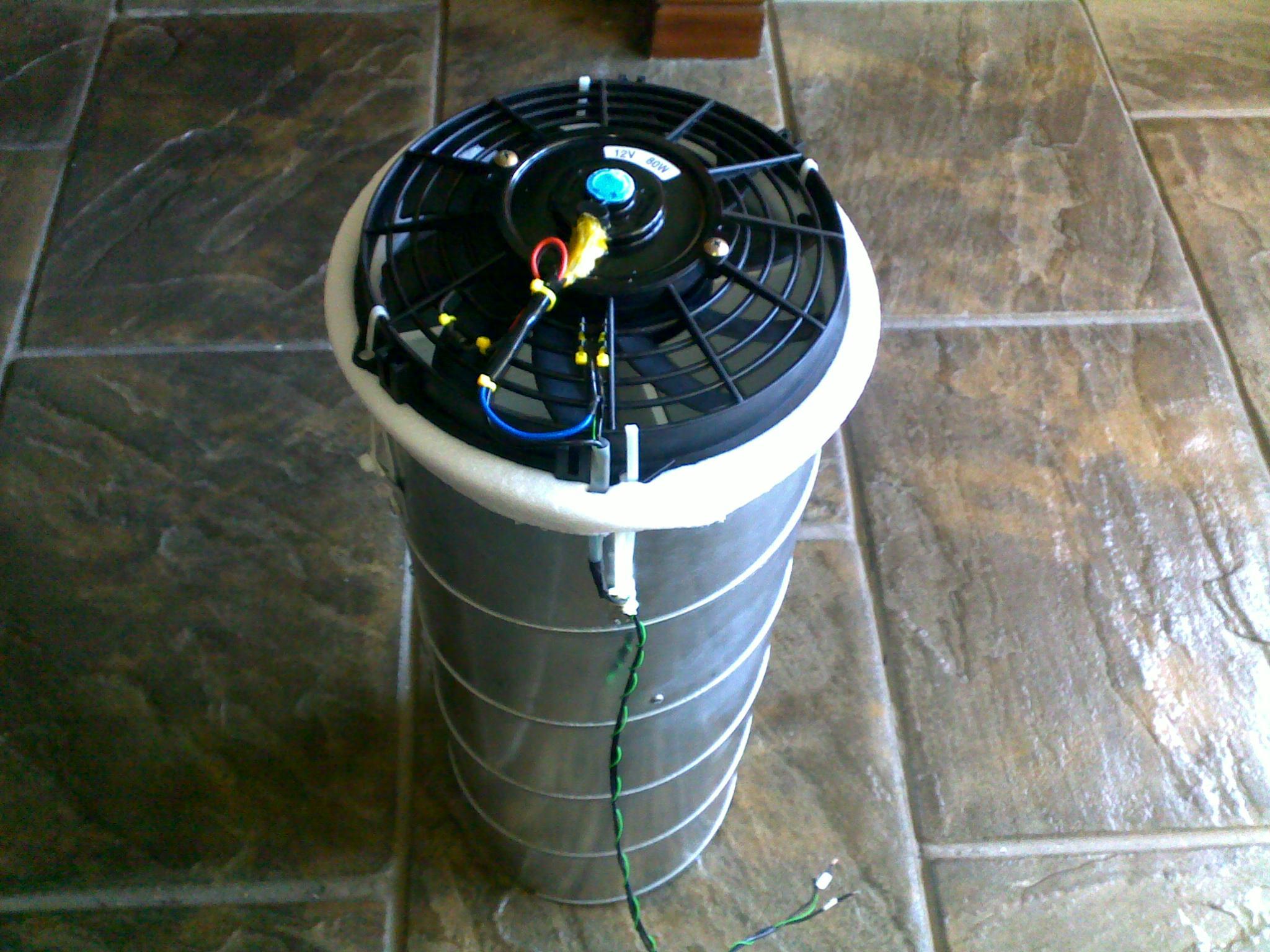

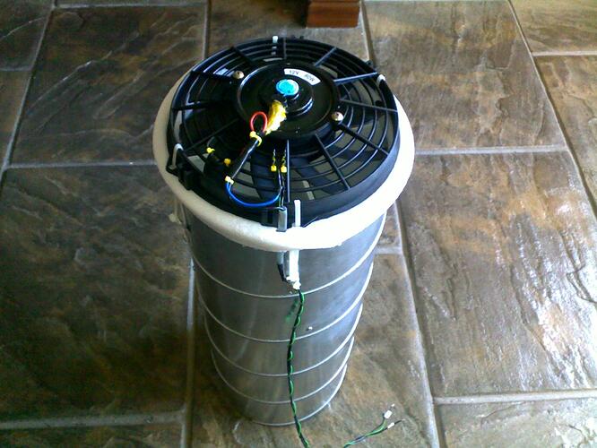

I made a musical (I use the term loosely :wink: car radiator fan, which
blew out streamers from the ducting when it was going fast and played a
tune when it was going slow, by pulsing the motor on and off. I stuck
another piezo on the motor as a pickup and that then went into an amp.
Electrically it’s dead simple - a RFP30N06LE MOSFET, beefy diode and a
couple of resistors, see for example
http://bildr.org/2012/03/rfp30n06le-arduino/
