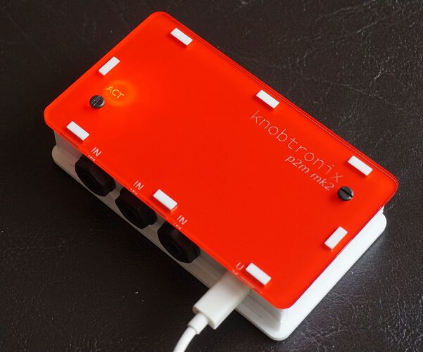

(white perspex with red spray paint sprayed into the engraving. excess
paint had been removed after the paint had been dried)

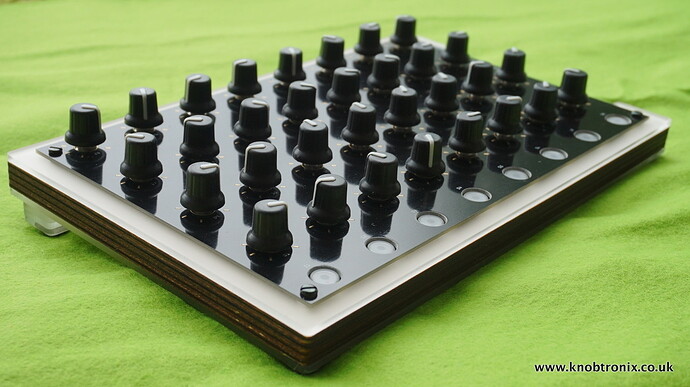

i’ve used a combination of plywood and frosted acrylic for good effect.
[image: Inline images 5]
and, beware of colours. i’d recommend choosing only one colour and a
neutral one. like white for all solids + red for highlights (or vice
versa). it’s easier to get it look good without being a designer. :slight_smile:

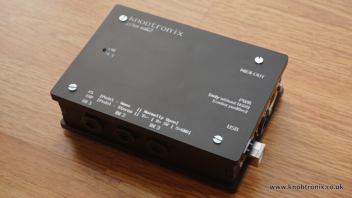

the frosted black - it’s called midnight black - is really pretty with
white highlights, in my opinion. rubbing off the excess paint does leave
some minor stains though which are virtually impossible to get rid of.

Looks very cool const. The stains on your last one may be due to using
acetone, as acetone will dissolve perspex - Its commonly used for solvent
welding perspex sheets together!On 23 February 2016 at 17:10, Constantin Popp constantin.popp@gmail.com wrote:

the frosted black - it’s called midnight black - is really pretty with white highlights, in my opinion. rubbing off the excess paint does leave some minor stains though which are virtually impossible to get rid of.
<DSC01332.JPG>
hope this helps,
