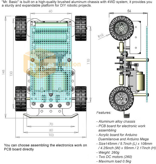

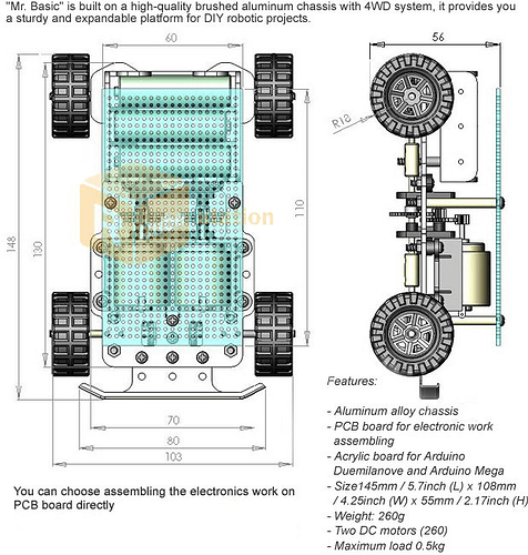

Just been looking around ebay for something different to work on next,
discovered this and thought I’d share the find:
Basic 4WD moving platform for robotics project:
Should be around 18quid all in.
http://is.gd/iiUxP
(links to ebay page)

Interesting, but I don’t see any motor control on it - I don’t think you’d
be able to drive it straight off an arduino. You’d need some transistors or
relays to run it.On 6 December 2010 20:30, Michael Rimicans heed@bigmassiveheed.co.ukwrote:

The arduino motor shield is a common accessory for these apps.
http://www.ladyada.net/make/mshield/
I don’t see any steering either…
One motor powers the left side wheels, the other the right side wheels.
You’d have to use differential drive to turn the thing.
