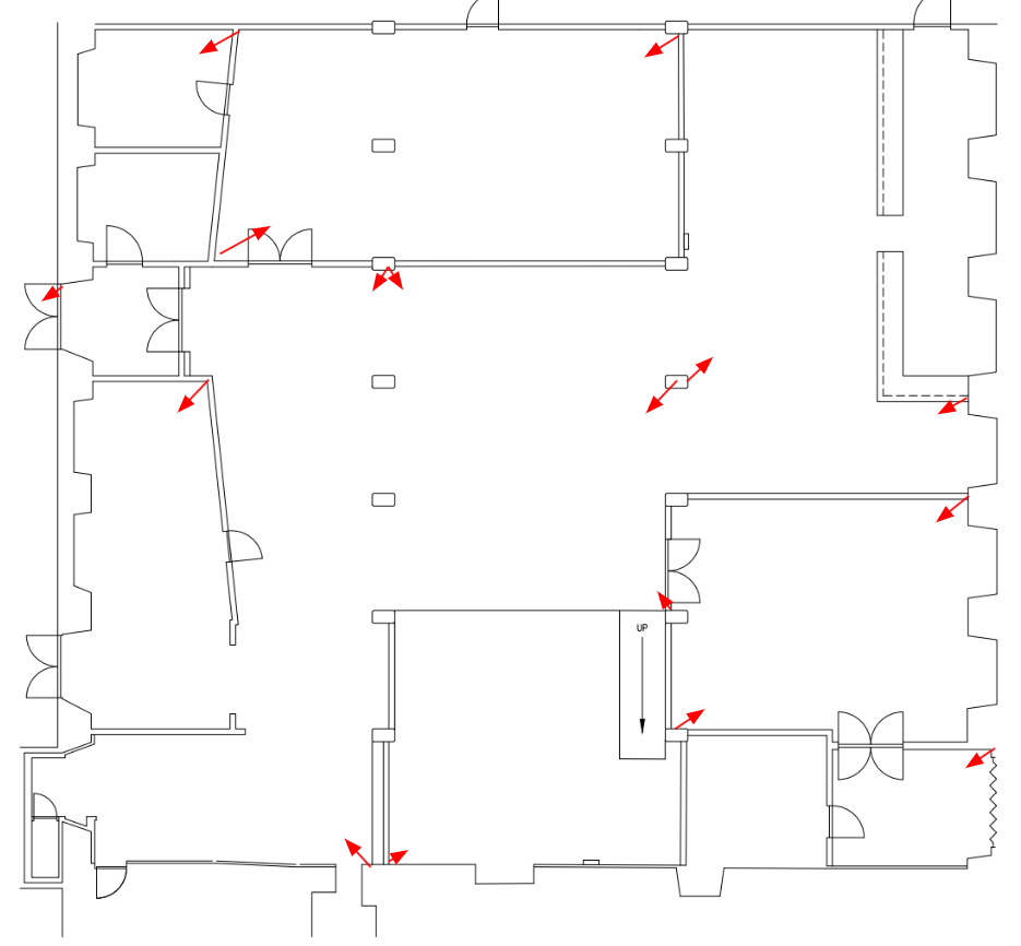

Yes, correct, I’m proposing cameras throughout the space. A 16 channel system would probably suit us well. It sounds a lot of cameras, but we have 11 rooms/spaces within the space to cover (excluding toilet).
Here’s a first draft of the system locations:
A system like this would cost £350 including 2TB harddrive.

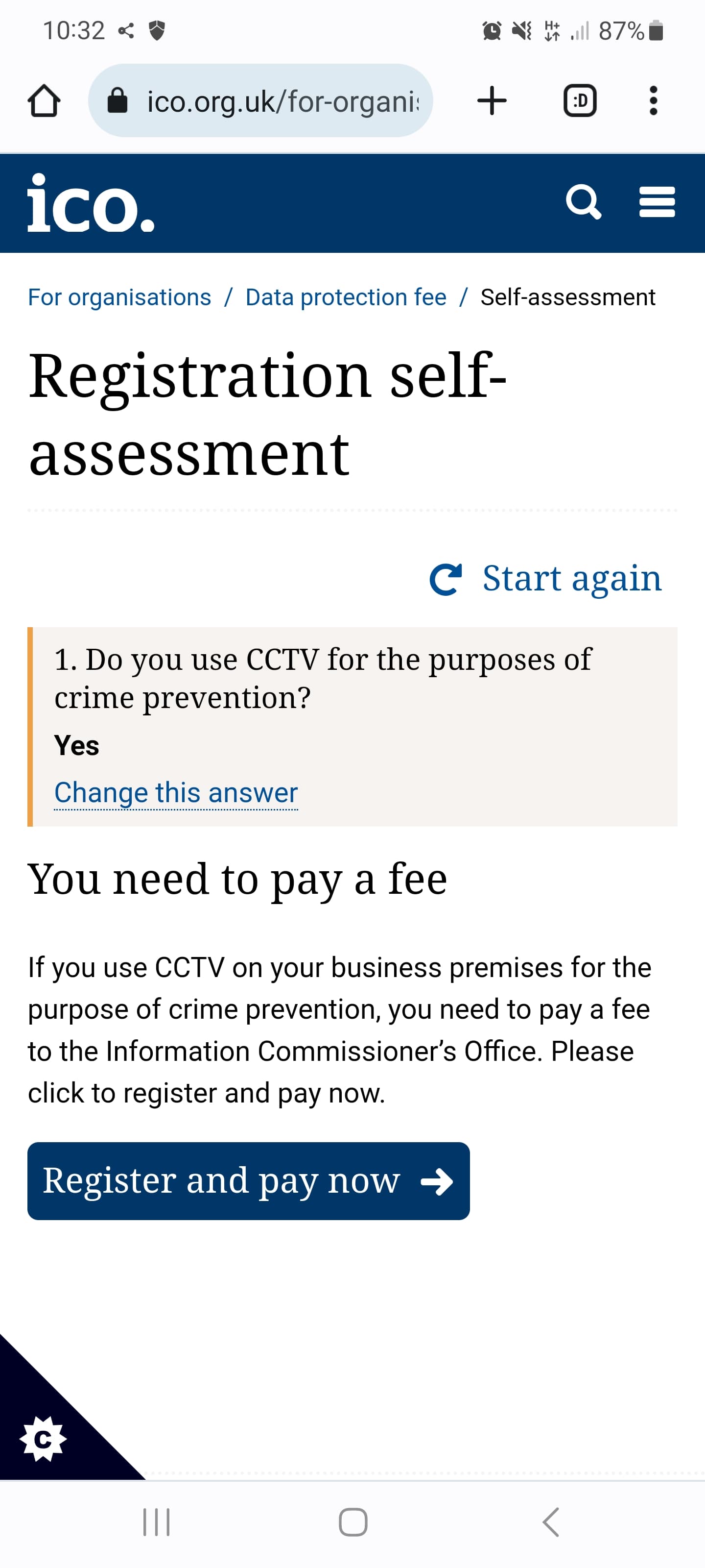

Also, for businesses using CCTV, an annual fee is payable to the ICO for any CCTV systems in use.

Jim, correct, I’m aware of the ICO requirements, hadn’t put thought to the audio recording, but it hadn’t occurred to me this would be recorded. To confirm, I wouldn’t be intending on an audio system. Good point on the camera facing the door.
