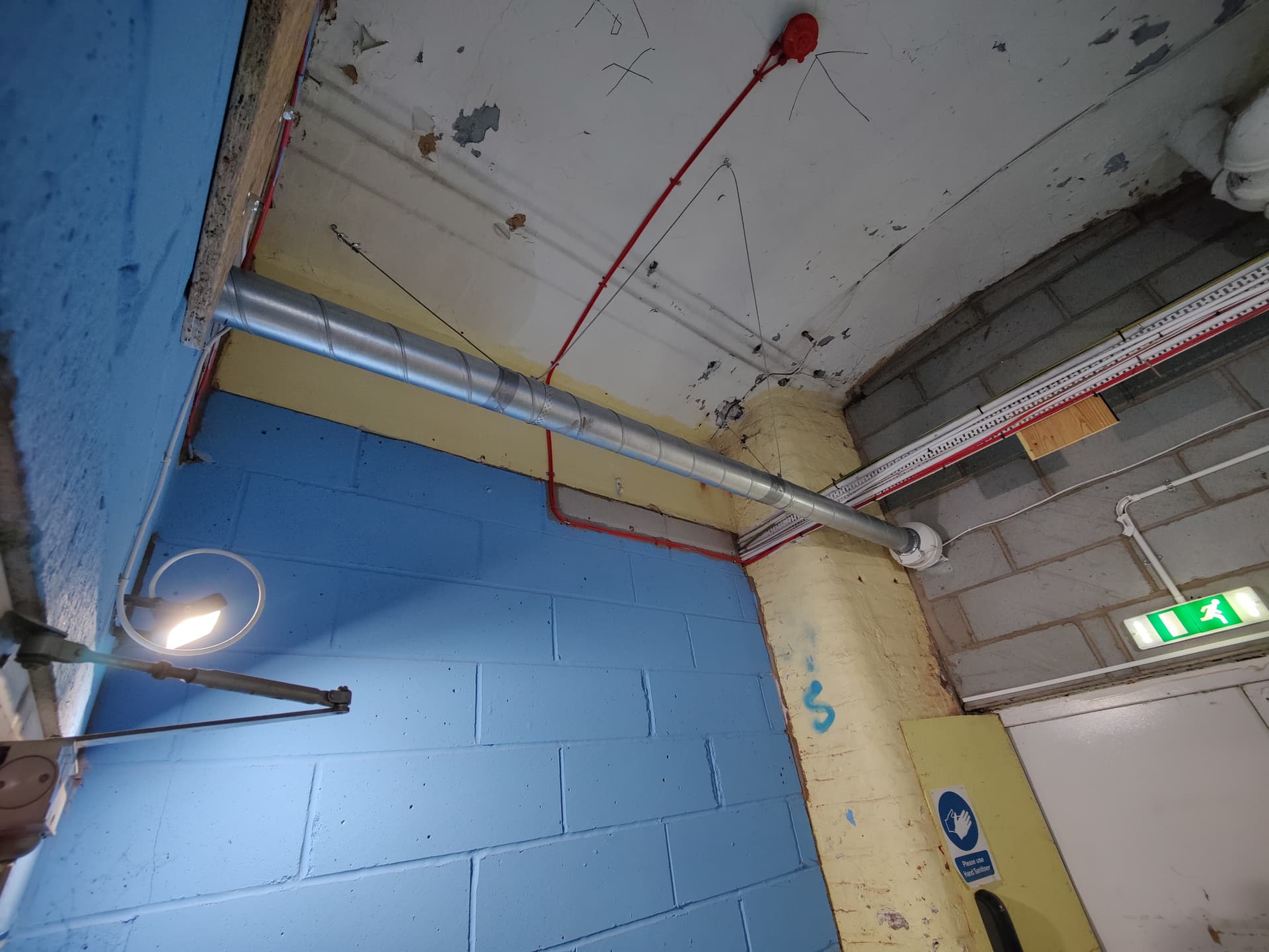

The pipework takes the fresh air from outside into the main space, through the vestibule. The pipe is supported by steel cable secured to the ceiling with anchor bolts:
Inside the pipe and at the barrier with the inner wall is a fire baffle, which will shut and permanently seal if it gets too hot such as in a fire.

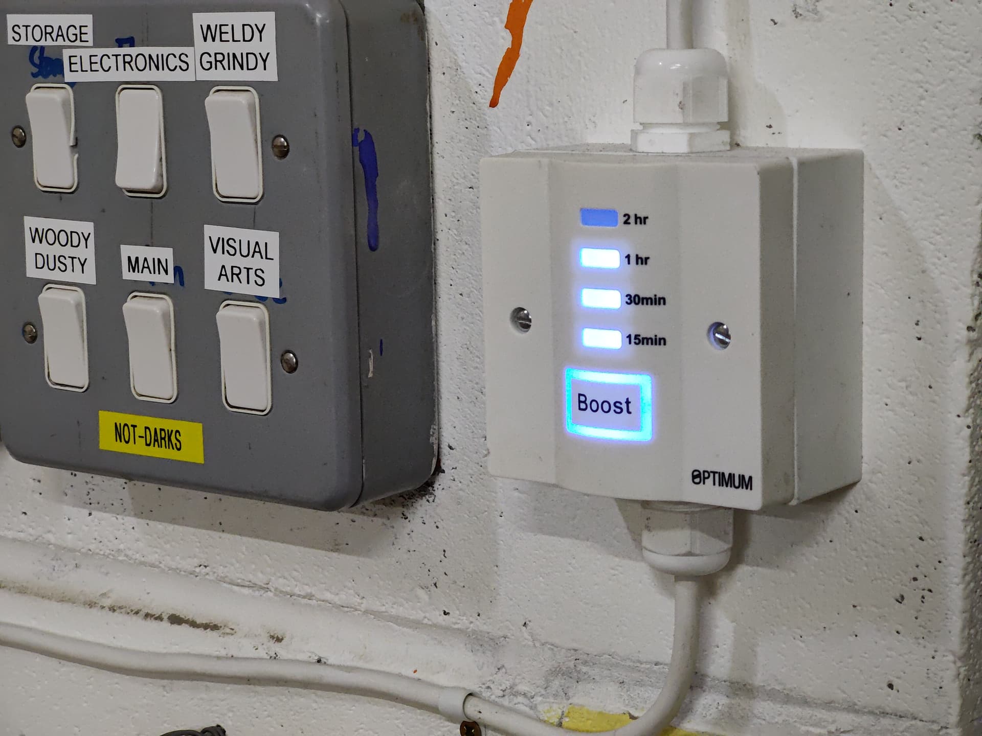

The fan is controlled by a boost timer found by the light switches. This lets people choose if they want outside air in without letting it be left on:

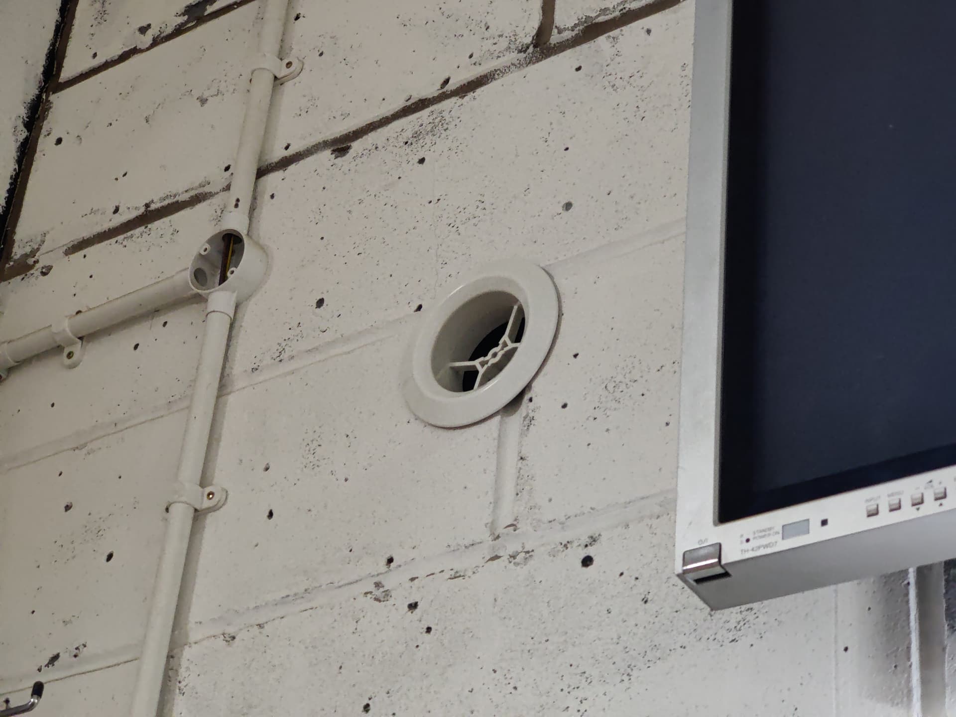

The fresh air enters the space by the TV and can be felt some distance into the main room. This works in tandem with the air filter which together makes the space a more pleasant and healthy place to be.
Ventilation will help with dust issues, keep the space at a positive pressure and with covid still about and getting people ill it’ll help push out any nasties in the air.
