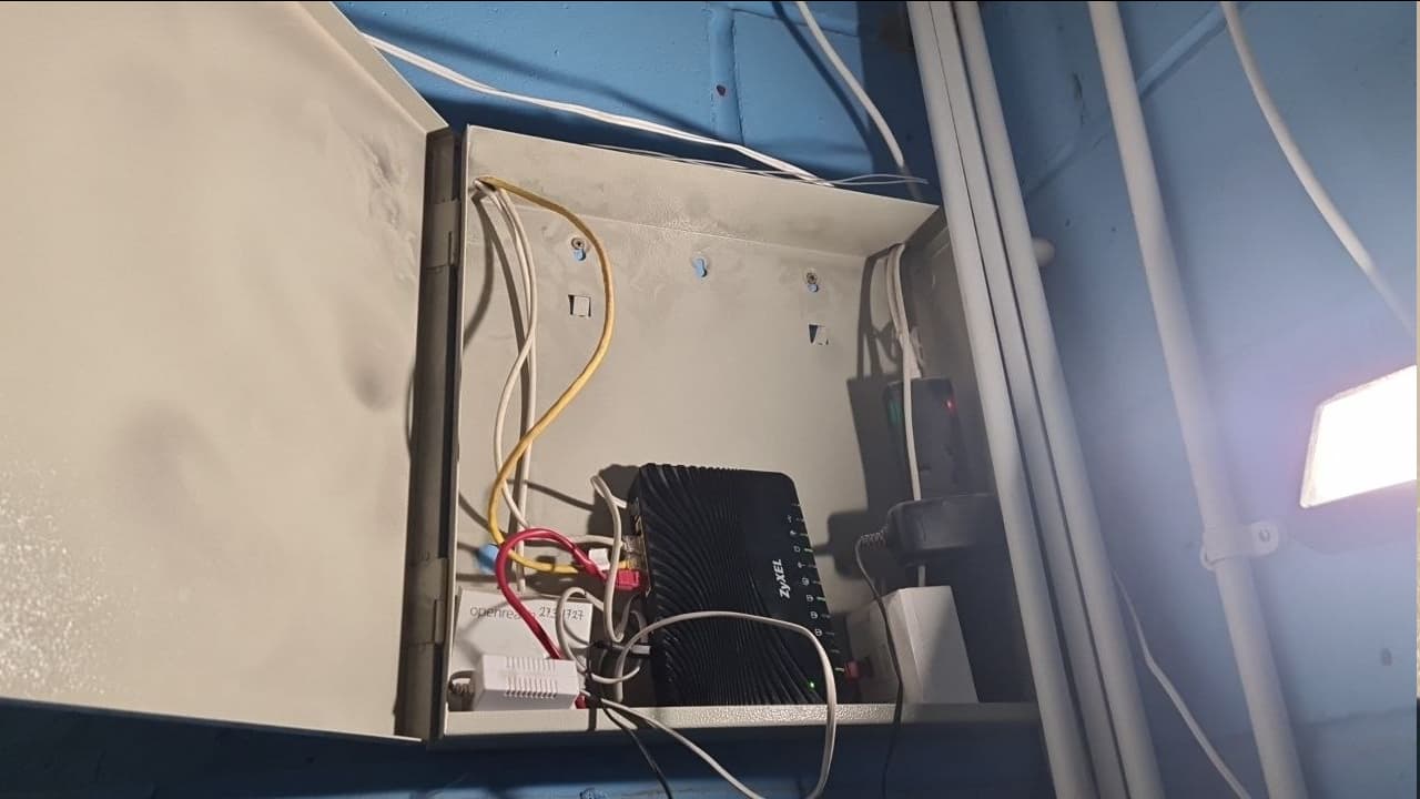

ADSL Router
In the front door area in a small metal box (near the entrance to the toilets)
this is where the ADSL internet router is located.
It’s a ZyXEL ADSL router model VMG1312-B10A
It has 4 Ethernet ports on the back, 3 of these are wired up to the rest of the network within the hackspace
I can be reached via http://172.16.0.1/index.html which I’ve got the login details for
although there are some setup details hidden as mentioned above if we wanted to replace it.
I believe this acts as the DHCP server, IP Range 172.16.0.50 - 172.16.0.200
DNS is also set here for google to 8.8.8.8 and 8.8.4.4
The inbuilt wifi for this device is disabled as we use a seperate wifi endpoint

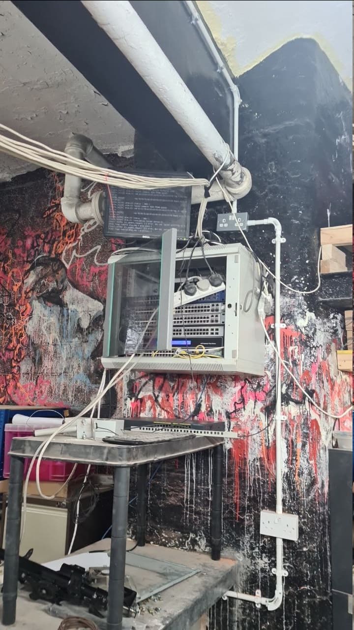

Switch Rack
Next point of call would be the switch rack which is where most of the cables probably end up
Multiple network switches here, including an NTP server I donated ages ago.

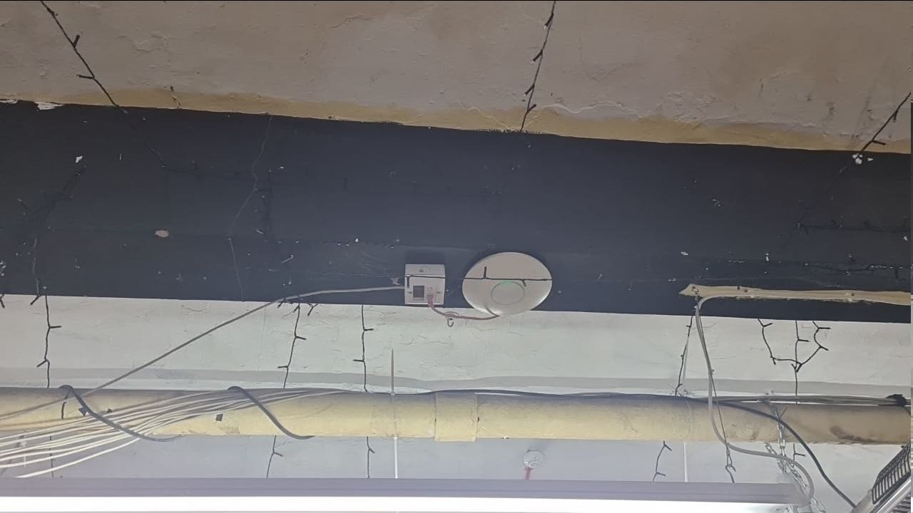

WIFI Router
I don’t know the login for this one, but it does reset when the adsl router reboots
It’s 2.4Ghz and I suspect looking at the wiring may be using power over ethernet
Ideally we could do with something running on 5Ghz as well, I have something at home I might try and bring in / setup in addition to this one.
The current one is fastened to the ceiling in the main area.
