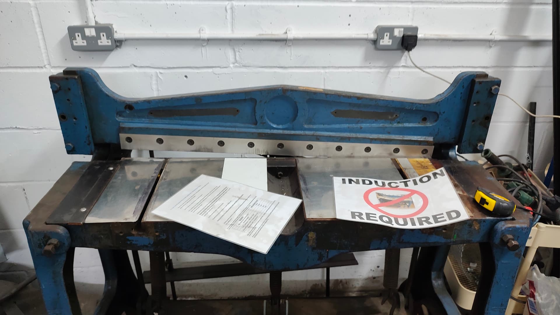

Thanks to (then new) member Laurence, we have a large guillotine in the back metal room. It has a blade about 94cm suitable for cutting sheets of thin metal, plastic, card, and hardboard.
Laurence kindly produced an instruction sheet, but the tool still needs a few things sorting before it can be put in general use:

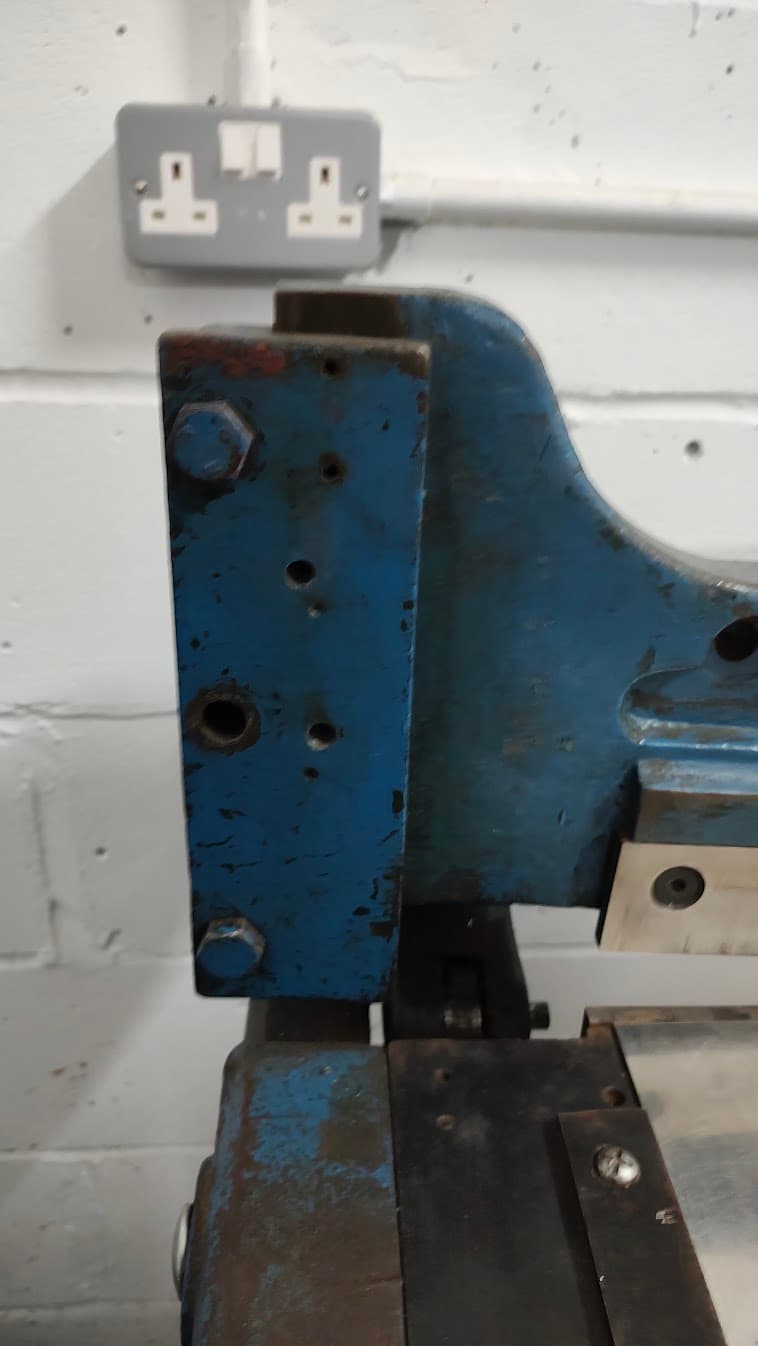

Safety features: The risk assessment has revealed (to me) the need for a guard in front of the blade and a safety lock to prevent unauthorised use. I bought a sheet of polycarbonate for a guard a few months ago and plan to fit it using the holes already drilled in the machine’s frame. The polycarbonate is very flimsy, so I plan to stiffen it with some steel angle I found in the rubbish pile.

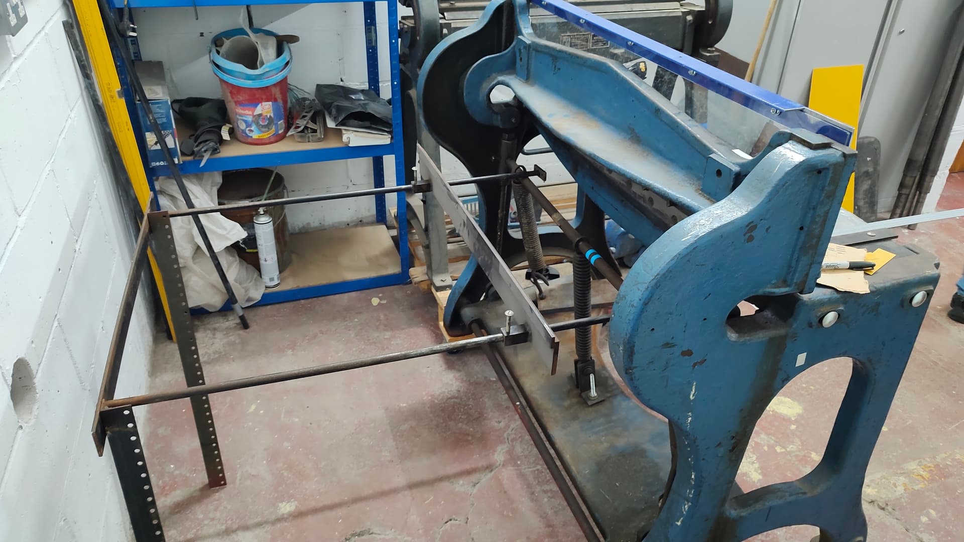

Final location
Right now the tool is on wheels. This was to make it easier for us to move it when we were unsure of where it wanted to live. It also makes it easier for the tool to be moved backwards and forwards in order to install the backstop (the thing at the back that lets you make consistent sized cuts). (Pic shows backstop rested in place, not properly bolted, BTW)
That backstop could actually be cut down to allow a max. 600mm cut which should be sufficient for most use cases and lowers the footprint slightly.
In doing the RA and speaking with Lawrence, we concluded that the machine would be much safer as a static tool with the backstop permanently attached at the rear. This probably makes it too large for the back metal room. The other factor is that it’s not really just a metal tool. And if it was buried away, VA people would probably not know it was there.

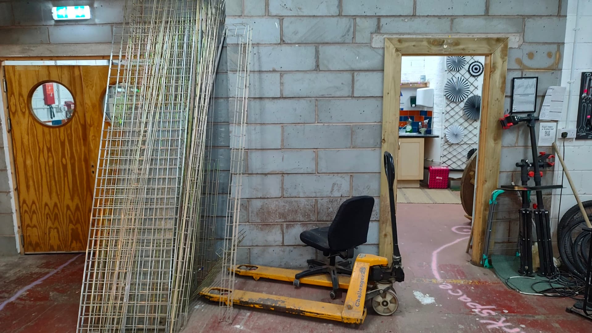

We thought it would be good to have it somewhere more prominent such as here

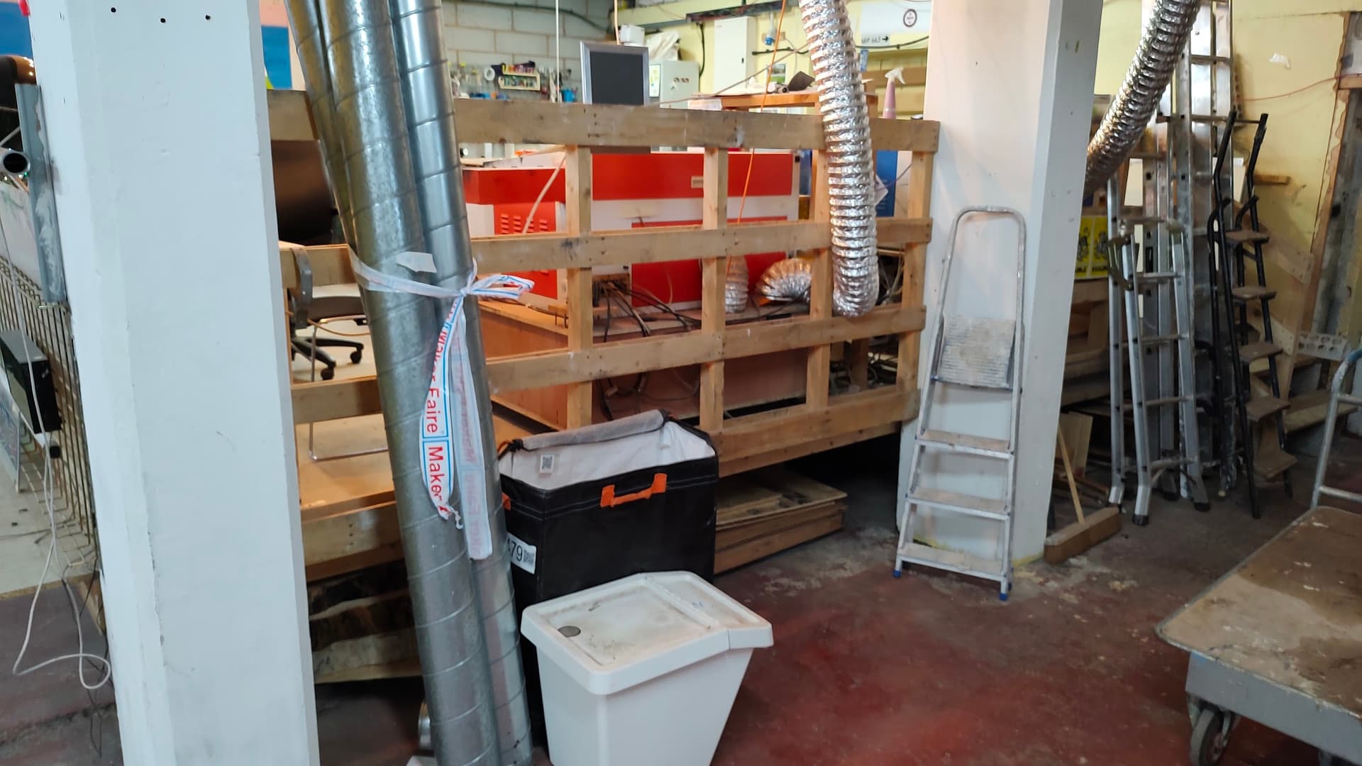

or here
Tagging @Marcus6275 because he has a good idea of infra requirements for large tools, and @Ben_Dooks who is now infra boss on the board. I also spoke informally to Rob and Jasmine about it last night, and we thought those locations seemed OK.
I think the best location is by the stage, and it’s slightly tucked away between two pillars. Yes, you have potential foot traffic going to large storage, but we could tape off the area in question.

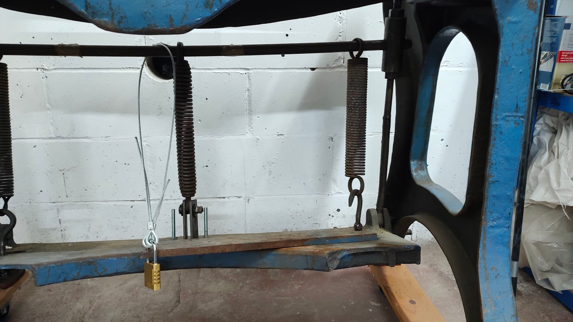

The tool now has a lock, BTW, restricting it to trained users only

  2. It has a backstop to help you make consistent cuts. With this installed (see photo above), the footprint is quite large — I feel excessively large for the back metal room.

My concern is if it’s too large to fit in the welding room I wonder how it will fit by the stage without intruding on the path, that’s a very narrow space with a busy path behind it which leads to the steps to the stage as well as the cave, large storage, and snacks.
