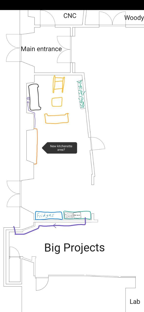

Adding this helpful plumbing diagram from telegram by @Fnhalluk

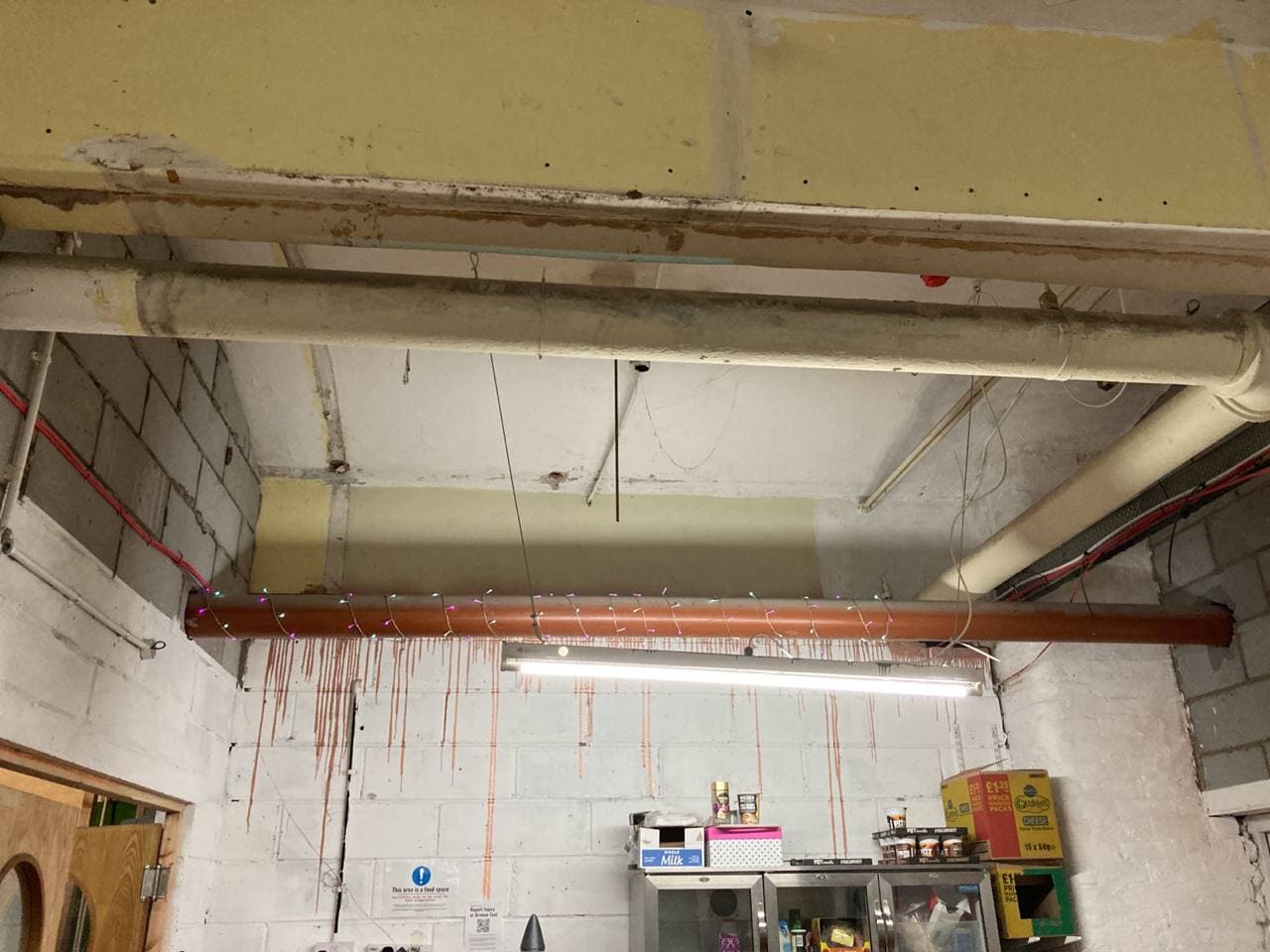

There is some question about the suitability of the drainage pipe behind the black sofa. Drainage is one of the main unestablished details in my mind. If we use the one behind the black sofa I’ll have to work out the appropriate plumbing trap etc. since it’s probably a sewage drain rather than a grey water drain.

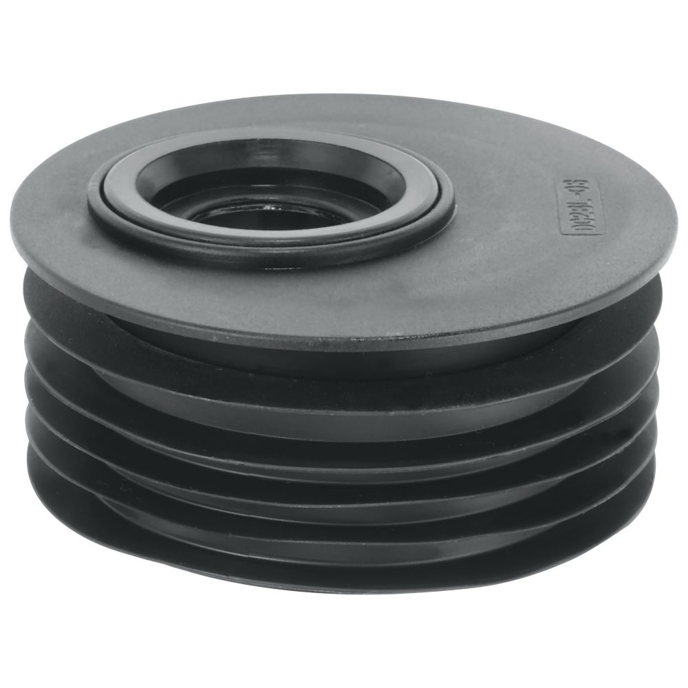

The pipe behind the sofa is a sewage drain, and when looking at this before I think we need one of these dudes:
Then we connect a 50mm pipe out of it, and to the sink which will have a u-bend. We could get an under sink u-bend that has a dishwasher attachment if it’s going to move to the kitchenette area.
Edit for clarity - most drain pipes are 40mm, but we can connect the two https://www.screwfix.com/p/mcalpine-zt26l-compression-straight-reducer-white-50mm-x-40mm/789jg

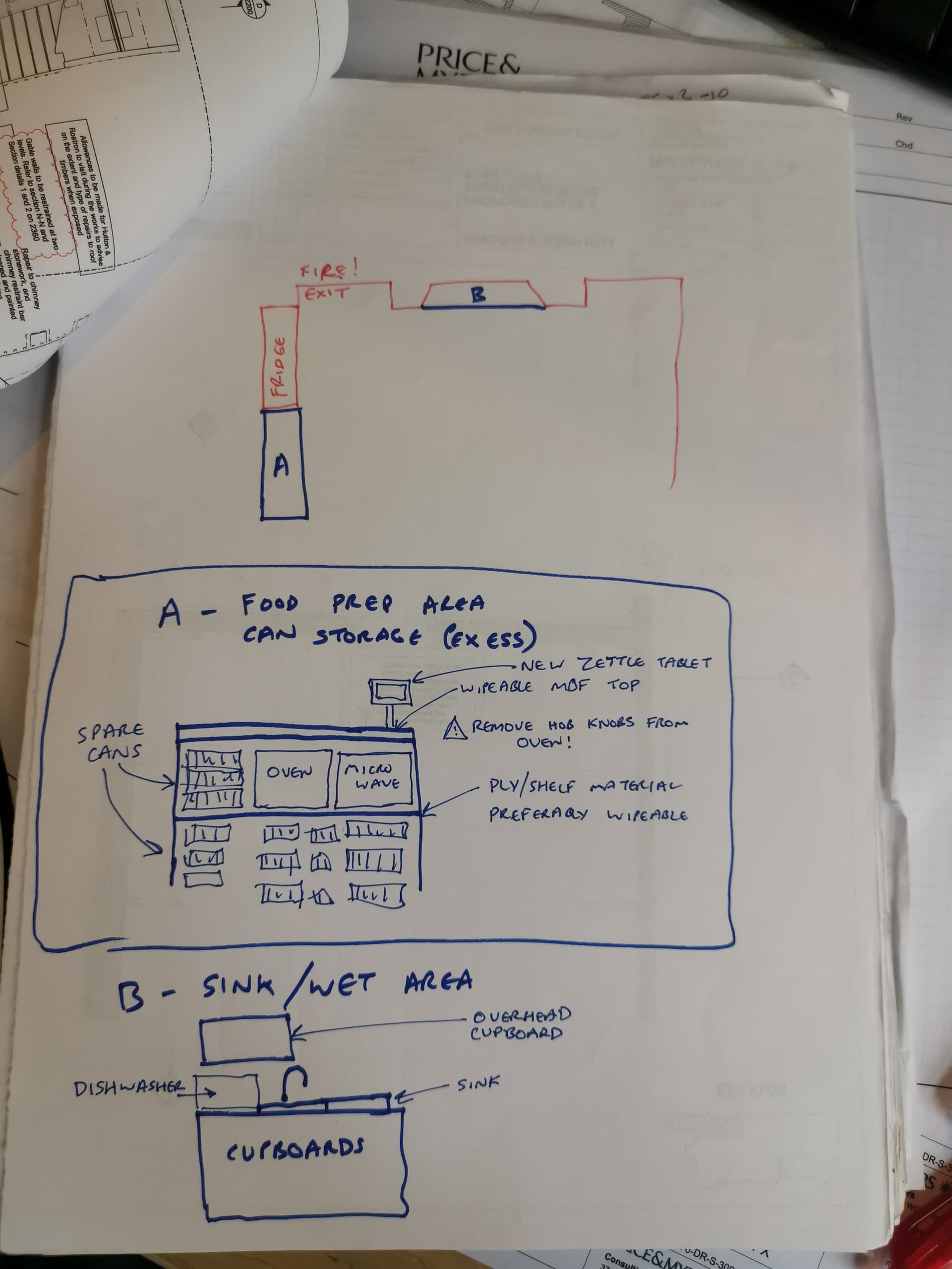

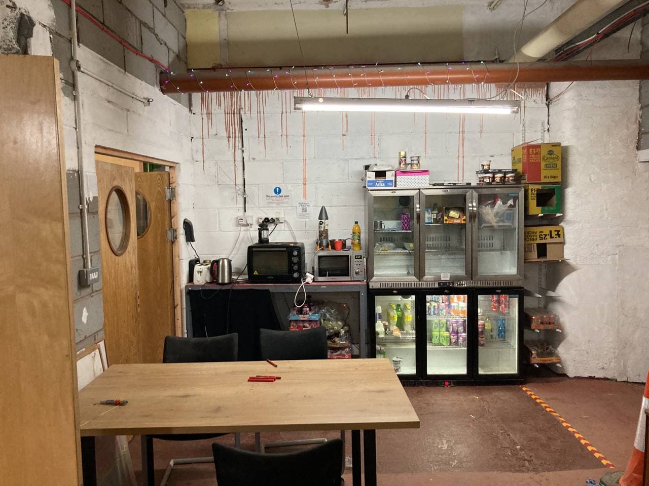

I picked up enough kitchen top for us to do both coves of the kitchen. Here’s what I pictured in my head :slight_smile:

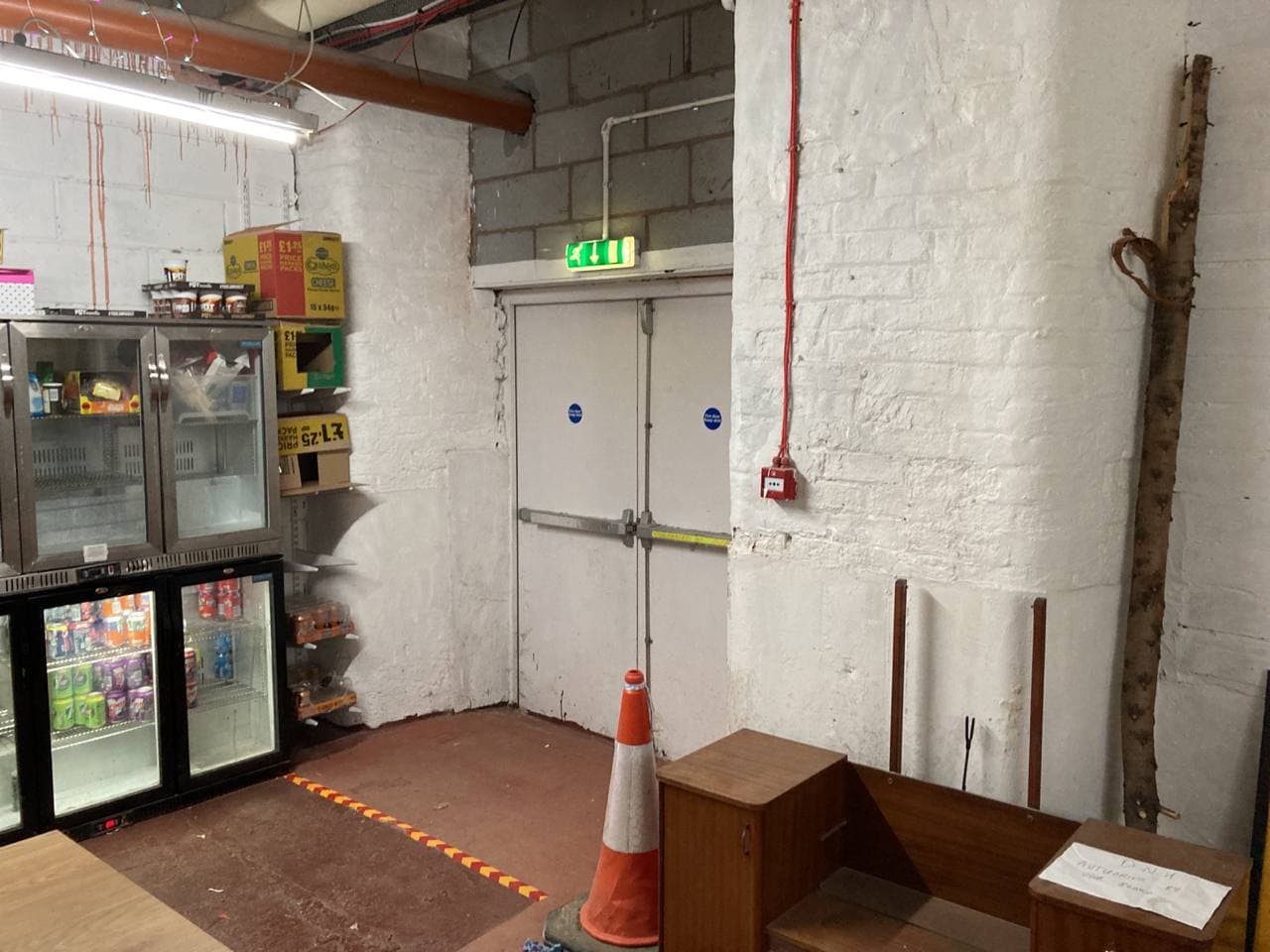

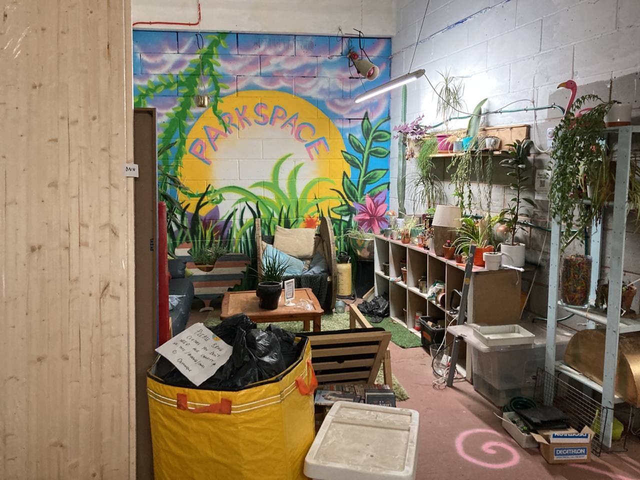

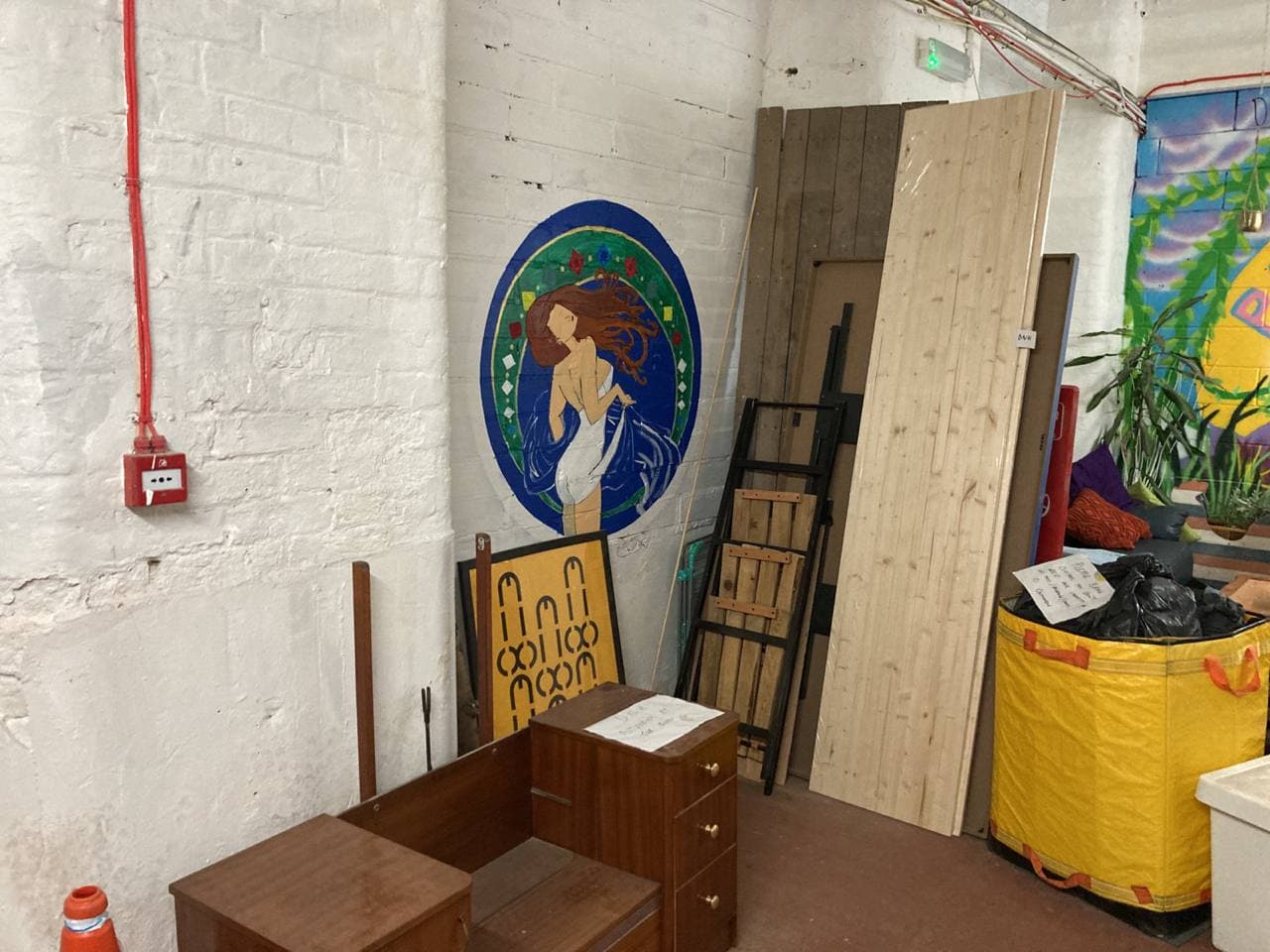

Snackspace photos by @SyntheticRabbit for reference
