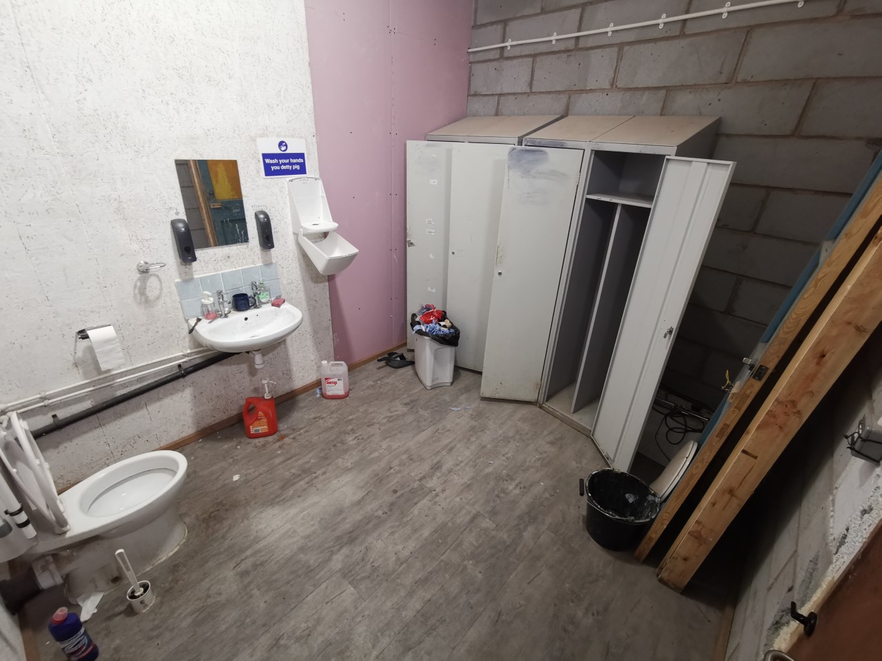

Before - Lockers would need to be removed.

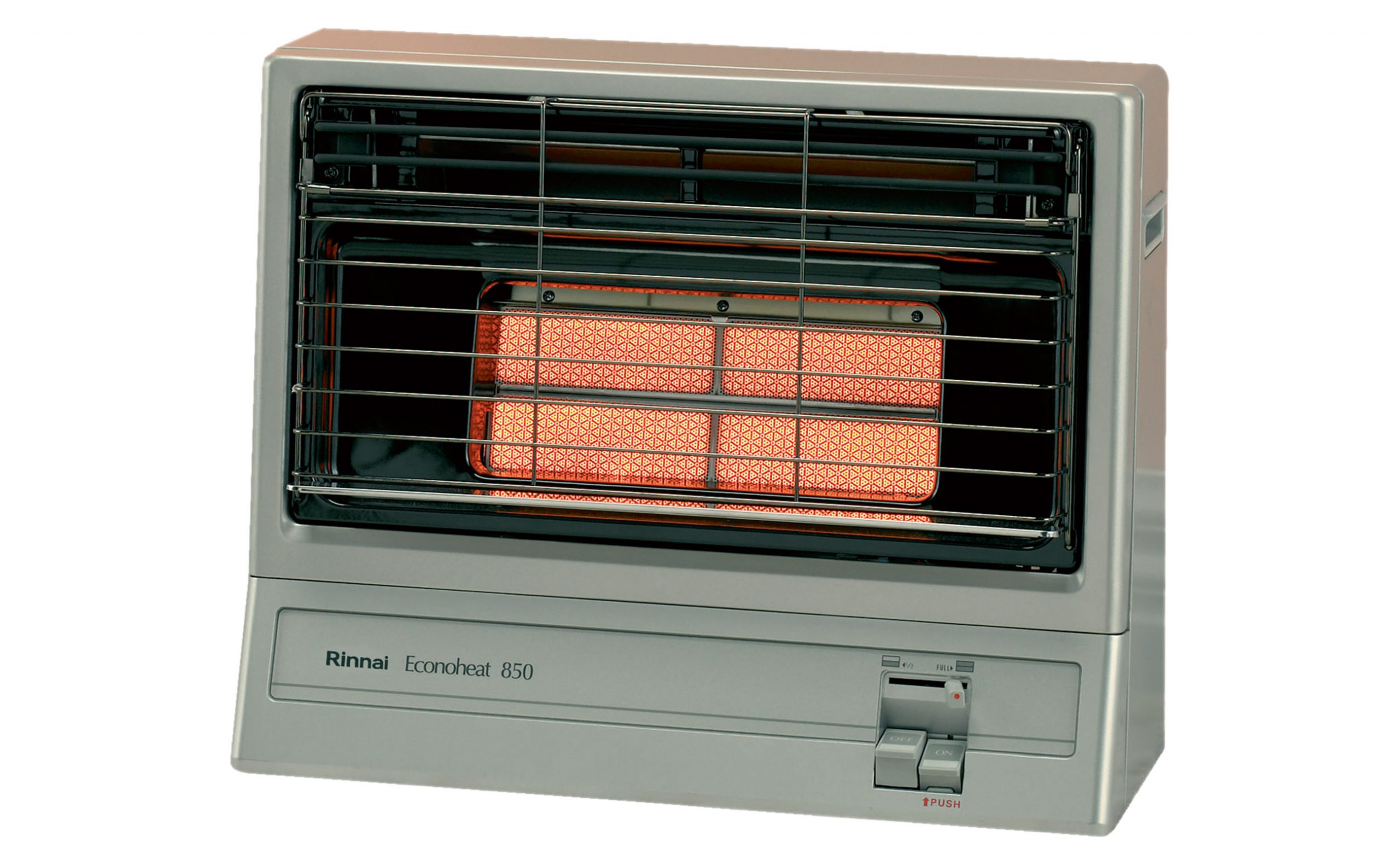

This was the style of heater I had in mind (hopefully more glamorous models are available) which is designed to be used indoors in people’s living rooms:
And thats if we get a heater at all. The commercially available stove from Homebiogas will have the health and safety side of things covered, with the proper pipework and fittings and the necessary detection systems. Your post comes across to me, as scare mongering, I’m sorry to say. Of the billions of people that have gas (methane) plummed into their homes, how many blow up because of a door hinge each year?
