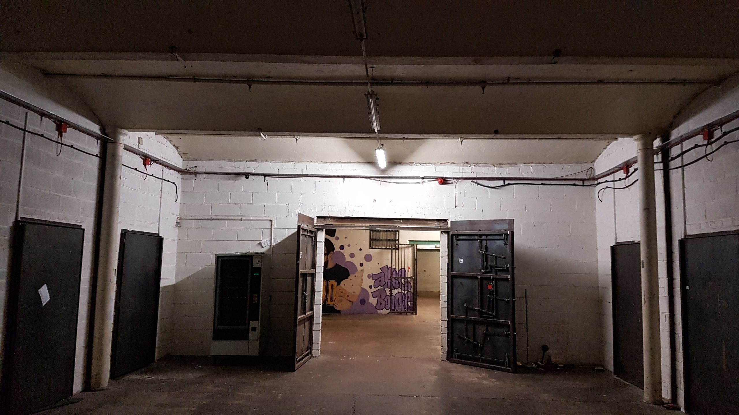

Corridor Outside the space
  • The light / starter just outside the metal door has now been replaced
Spooky dark corridor
I was able to get one of the lights working in the spooky dark corridor by switching the tubes around.
It looks as if one of the fittings is powered, but the other 3 including the emergency exit sign has no power I think

The only places I can think to look would be ether the open junction box on the wall near the lift
Or the circuit breaker above the abandoned virgin coke machine
(one of them appears to be off, there might be a reason for it)
