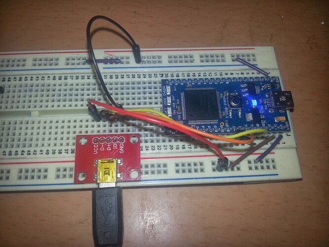

Has anyone managed to get an mbed to behave as a USB device? I have
connected the mbed up as shown:
[image: Inline images 1]

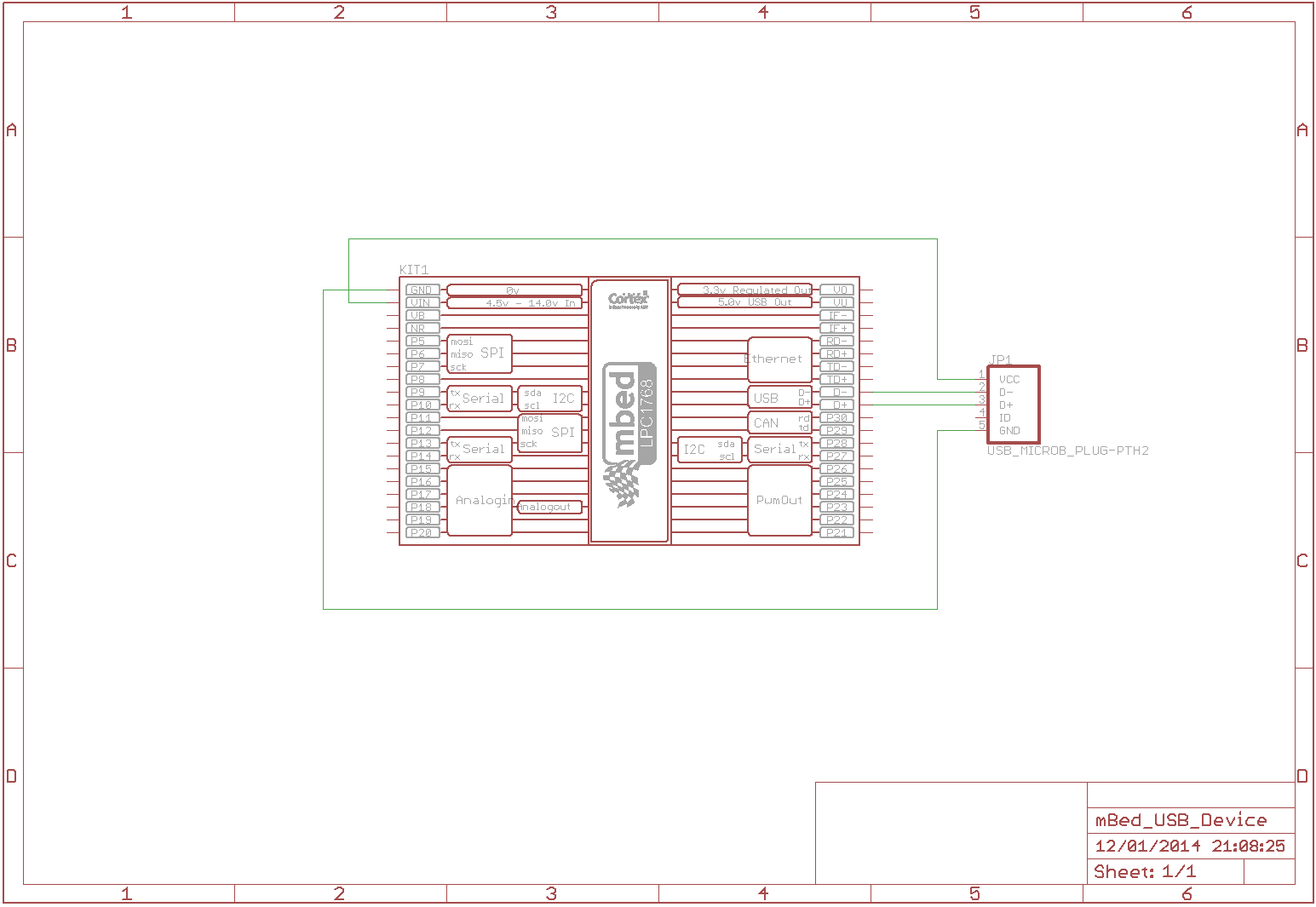

Here is the schematic for the purists!
[image: Inline images 2]

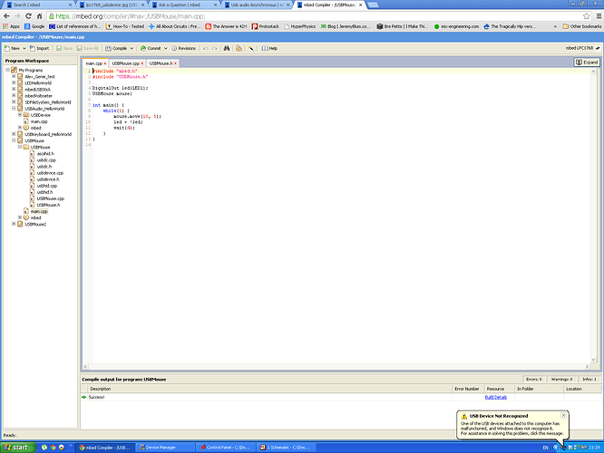

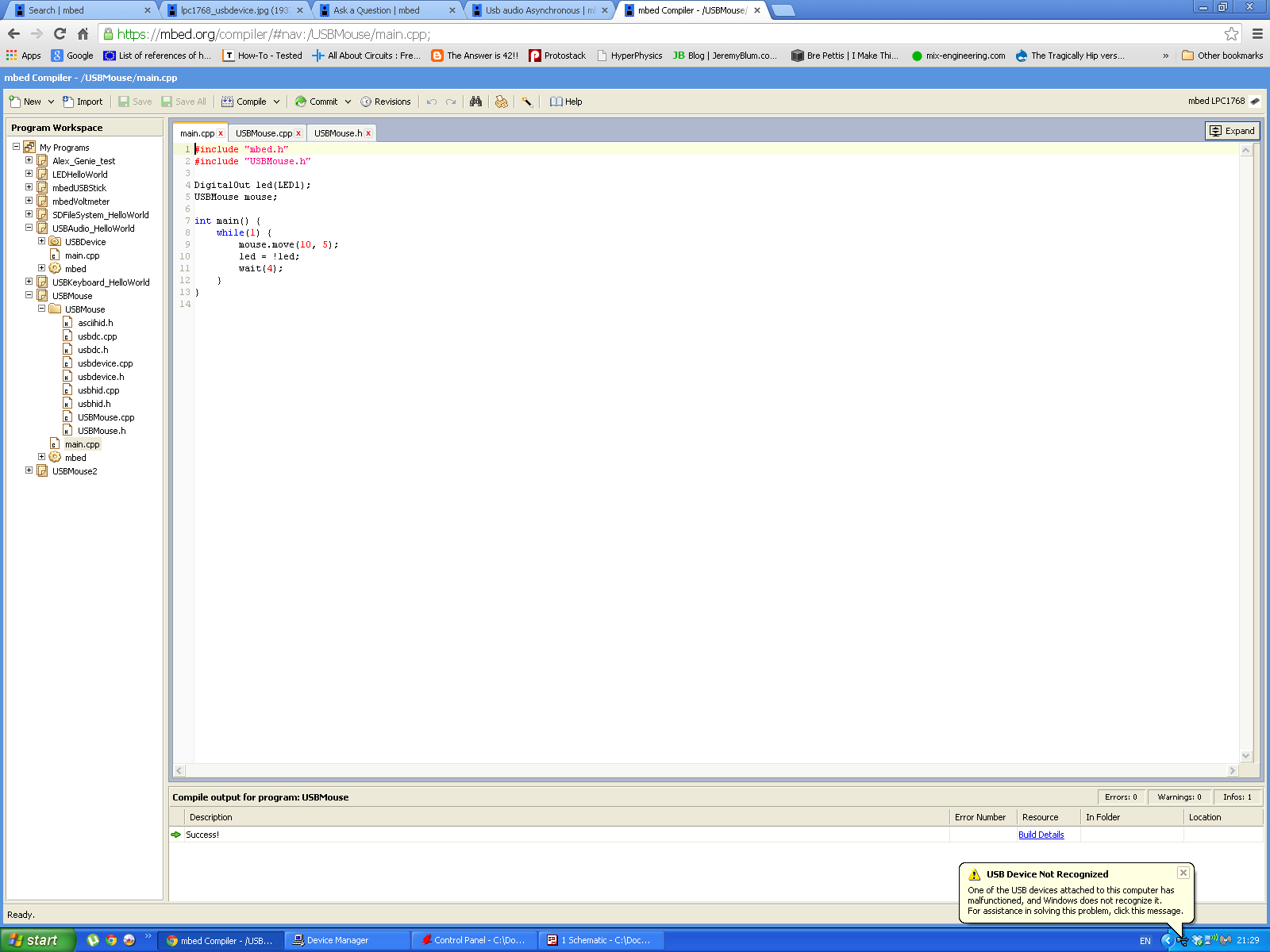

Here is what always happens:
[image: Inline images 3]

sorry, schematics are unreadable.

I assume Ben you are being sarcastic about the schematic. The error
message obtained was attached also…

You can always click on them to look at the larger versions…They are
boiler plate usb connections…nowt special

I am always presented with the following when I connect up to any PC. I
have tried three different computers with different operating systems just
to be sure:

The diagrams and code look OK, but in your photo you’ve got wires connected
to VU and VOUT and nothing on VIN. I don’t think you want anything
connected to VU or VOUT.On 12 January 2014 21:57, Alexander Lang alexanderlang1980@gmail.comwrote:

I’m using the +5V pin on the right hand side to connect power to the mbed.
The other 3.3V pin is connected to the breadboard bus but not connected to
anything else.
The circuit was connected as described and depicted in the handbook
picture.
Doesn’t truly matter as it still doesn’t work.

I’ve noticed that when my USB device is detected it’s VID and PID numbers
are 0000. This doesnt’ match anything else and isn’t correct which
suggests I have either poor code or fried my mbed in some way. Doesn’t
seem likely as it works for everything else. Does anyone have an mbed
motherboard I can test it in?

I have fixed my issue…I found deep within the USB library contructor that
the VID and PID number were set to 0000. I found a generic USB driver file
and set them to the number referenced and it was detected and works as a
virtual serial port. Now to turn my mbed into a 32Gb USB stick using an SD
card!
Cheers for the replies help and support people!
