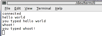

I’ve got avr-libc stdio working with the Minimus, so if you have a
FTDI board you can wire it up to PORTD2 & PORTD3 and use it for
printf-style debugging:
start_serial_baud(SERIAL_TEXT);
char buf[IBUFSZ];
while (1) {
    fgets(buf, sizeof(buf), stdin);
    printf("you typed %s", buf);
