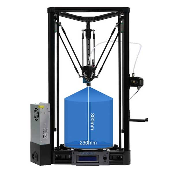

I have a modified Anycubic Kossel Linear Plus (linear slides)
which has a build volume of around 230 dia x 300 high
although I think newer models are around now
I’ve added a duet wifi board to it so that it’s 32bit instead of 8bit (this was additional cost)
