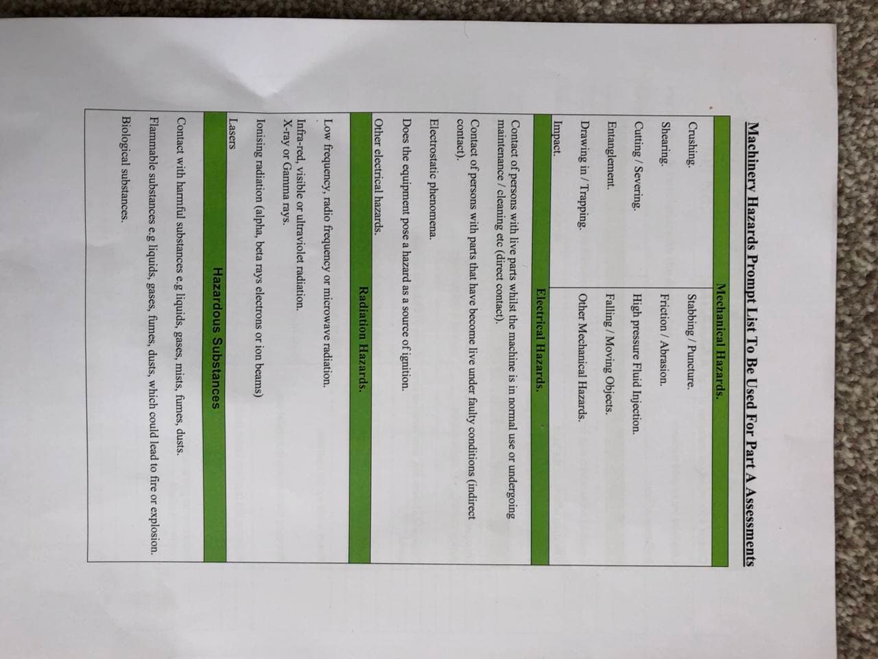

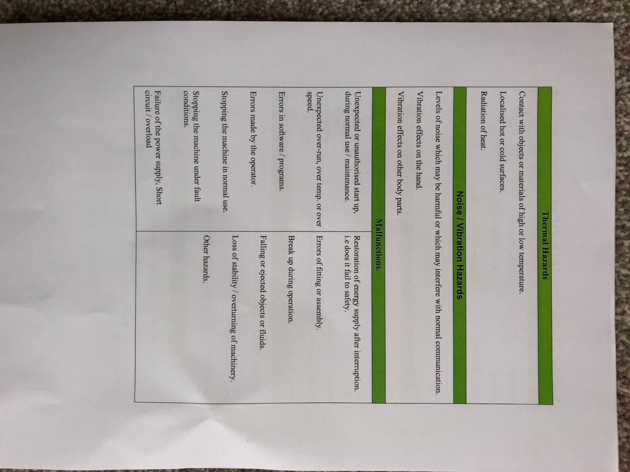

Hazard prompt sheet:
Hazard Prompt Sheet for Risk Assessments - Google Docs
I’m not sure we need one for Oscilloscopes, it’s basically a fancy multimeter for measuring voltage over time on a graphical display.
Cool, thanks Richard. I put it on the list because it was done a while back in the old format, but I’ll take it off.
Can you think of anything in electronics that might need a risk assessment?
I’m looking to do the mill after tomorrow when I’m trained. I’ll also do welding if/when we get it sorted :crazy_face:
@Josephxtian here is the hazard prompt sheet I was telling you about
Do you mind putting that in the folder (if you think it would help)?
Cheers Mike. I’ve typed it up because i’m bored on a train and it means we can adapt it as we need in the future.
Updated my post above also with the link.
