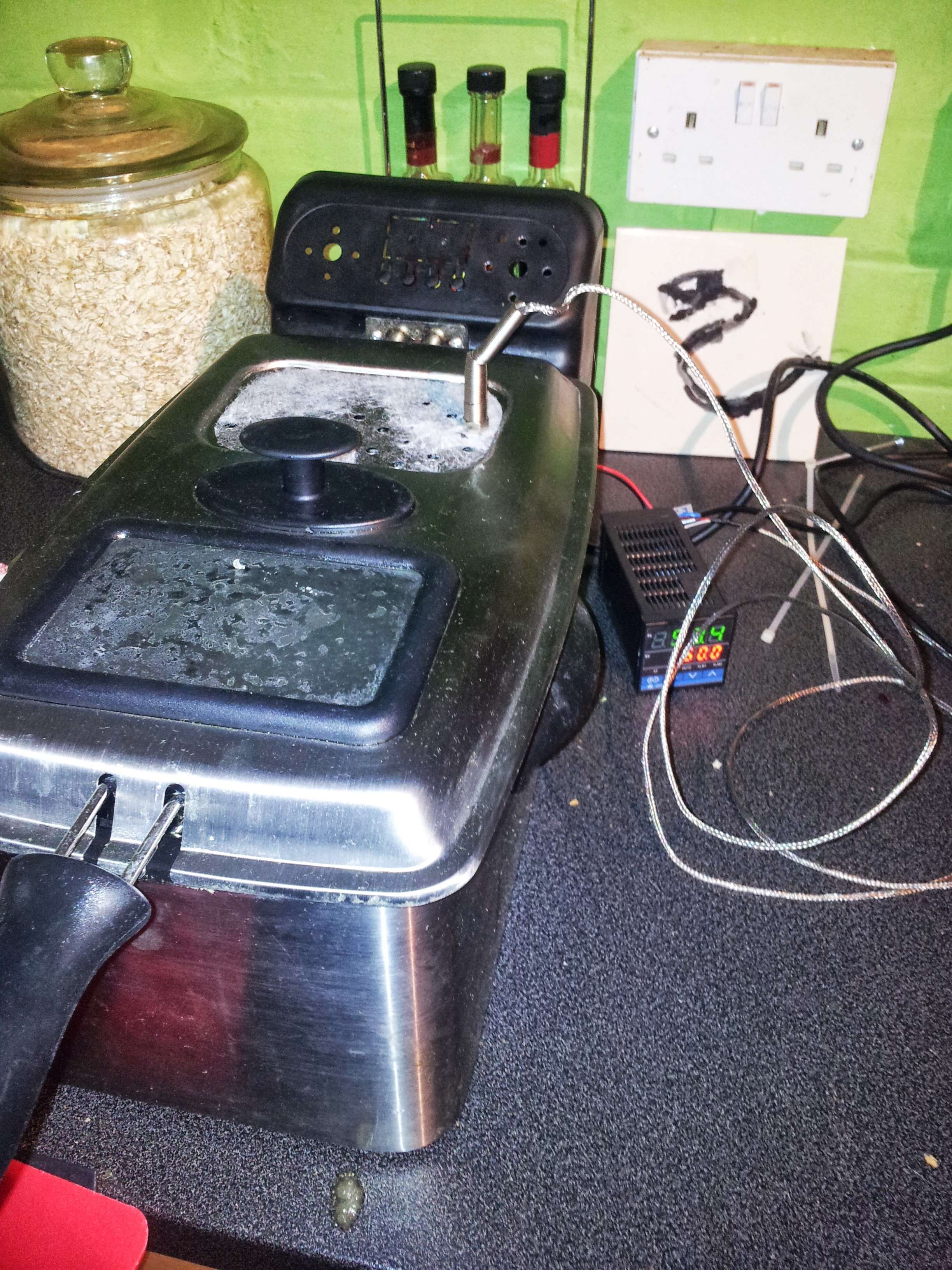

*Sous Vide Machine - *to make delicious science food! Basically a deep
fryer with the controller ripped out and replaced with an ebay PID unit,
full of water. Set it to 55 degrees, put in a steak in a ziplock bag, end
up with DELICIOUS steak -

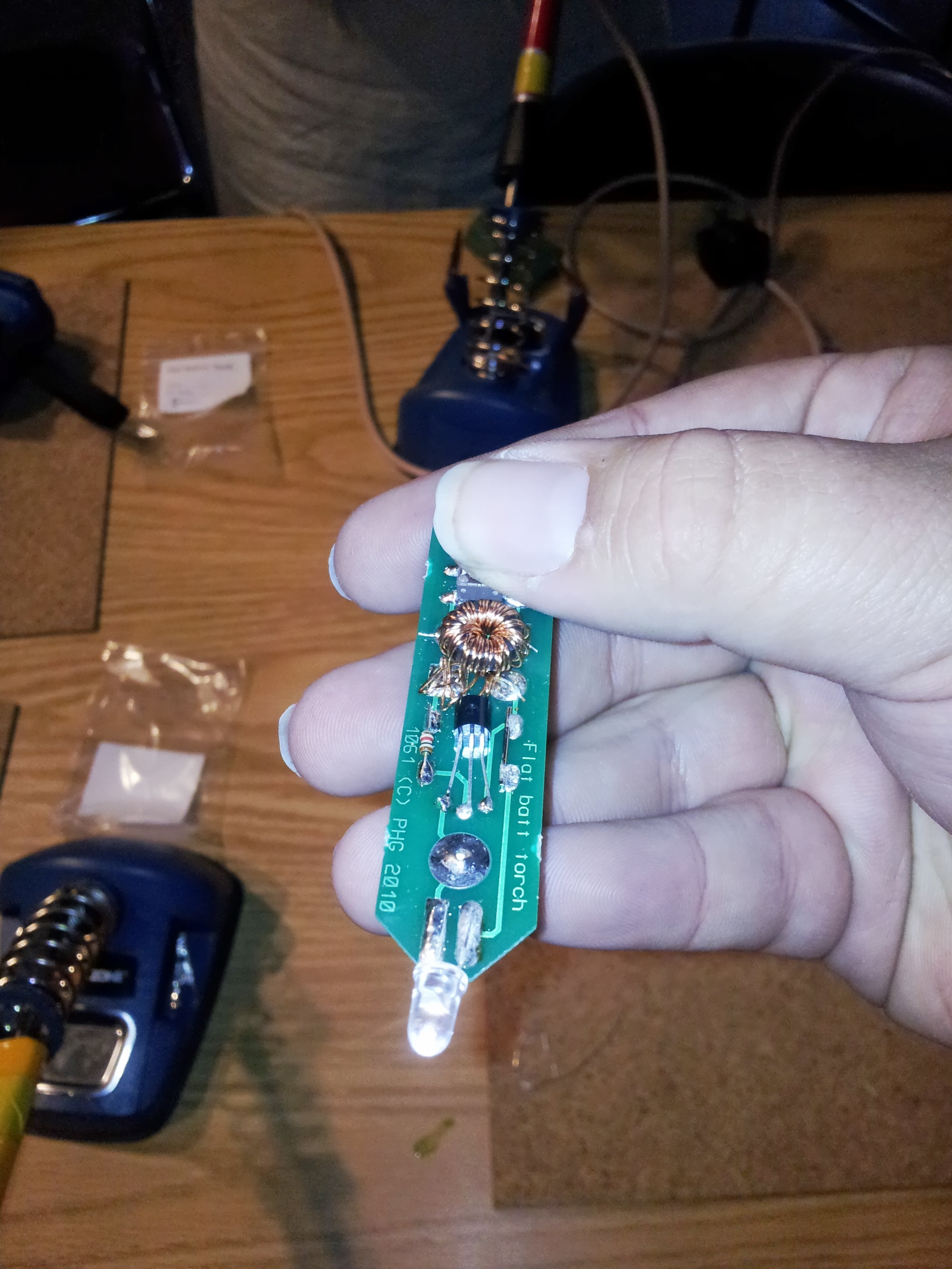

Joule Thief (flat battery torch) - Alex and I ran a workshop this weekend
at Castlefield gallery building Flat Battery torches. While not
fantastically well attended, everyone left with a working torch, the only
ones that didn’t work first time were mine and Alex’s!

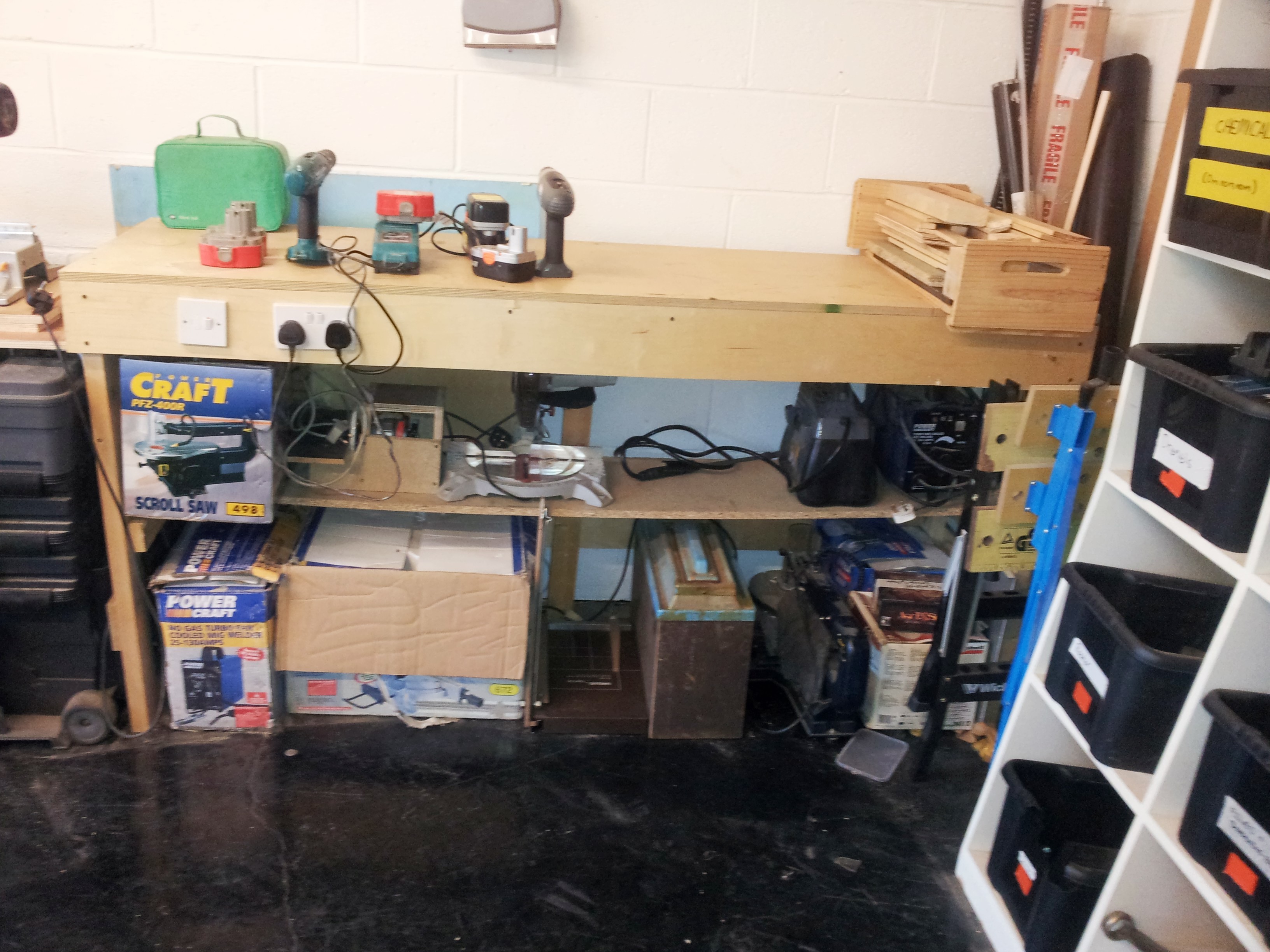

*A shelf in the workshop - *I was a bit fed up with the big pile of
assorted tools under the second workbench - this isnt a massively strong
shelf, but it’ll do for the light tools for now :slight_smile:

unit, full of water. Set it to 55 degrees, put in a steak in a ziplock
bag, end up with DELICIOUS steak - http://www.seriouseats.com/2
010/03/how-to-sous-vide-**steak.**htmlhttp://www.seriouseats.com/2010/03/how-to-sous-vide-steak.html
weekend at Castlefield gallery building Flat Battery torches. While not

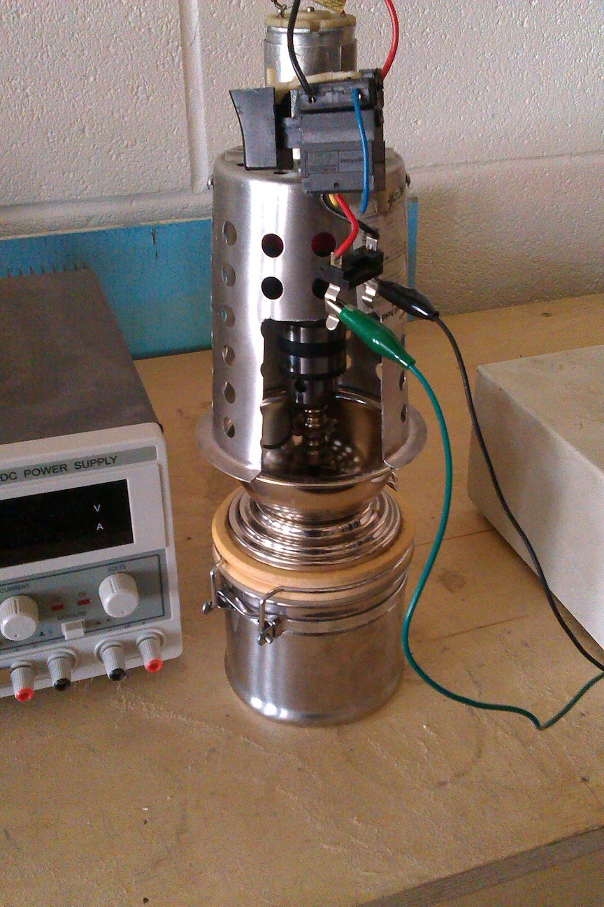

At the space I’ve been slowly working on my coffee grinder:
[image: Inline images 2]
I received a manual burr grinder as a gift a while ago, but it takes 20
minutes to grind enough coffee by hand to brew up a cafetiere. HacMan had a
cordless drill with a dead battery and no charger so I stripped it down and
coupled it onto the coffee grinder’s shaft. The bit on top which holds the
motor is a utensil holder from Wilkinson’s, which was surprisingly hard to
machine. Next steps are to join the utensil holder onto the coffee
grinder’s top and find or make a speed control for the motor.

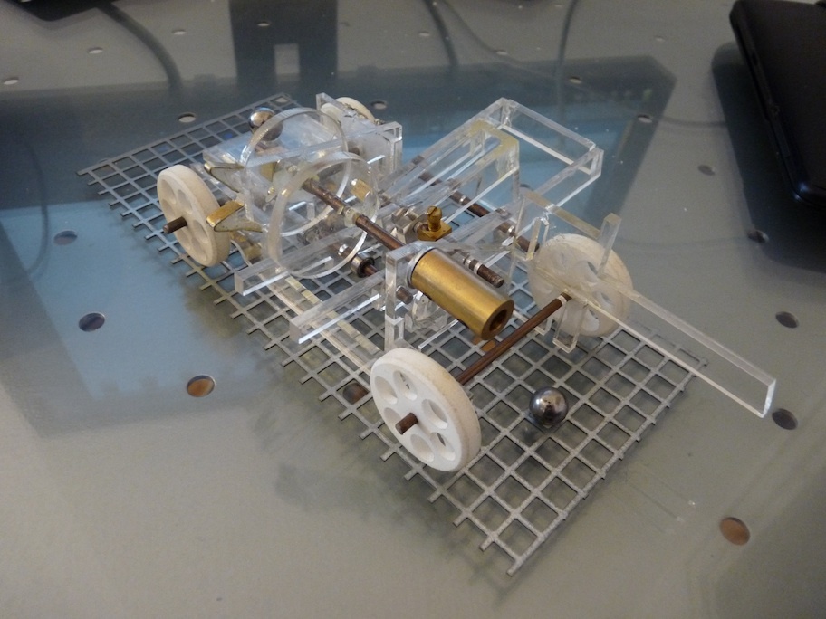

The other thing I’m doing for MMMF is this machine which executes a
Turing-complete cellular automaton called rule 110. I’ve done other more
complicated mechanical computers before but they’ve never worked very
reliably, so this is my attempt to simplify, I think it’s down to 8 moving
parts now. Now that Bob’s shown me how to use the laser cutter I can start
work on this again!On 1 July 2013 20:27, Bob Clough parag0n@ivixor.net wrote:
