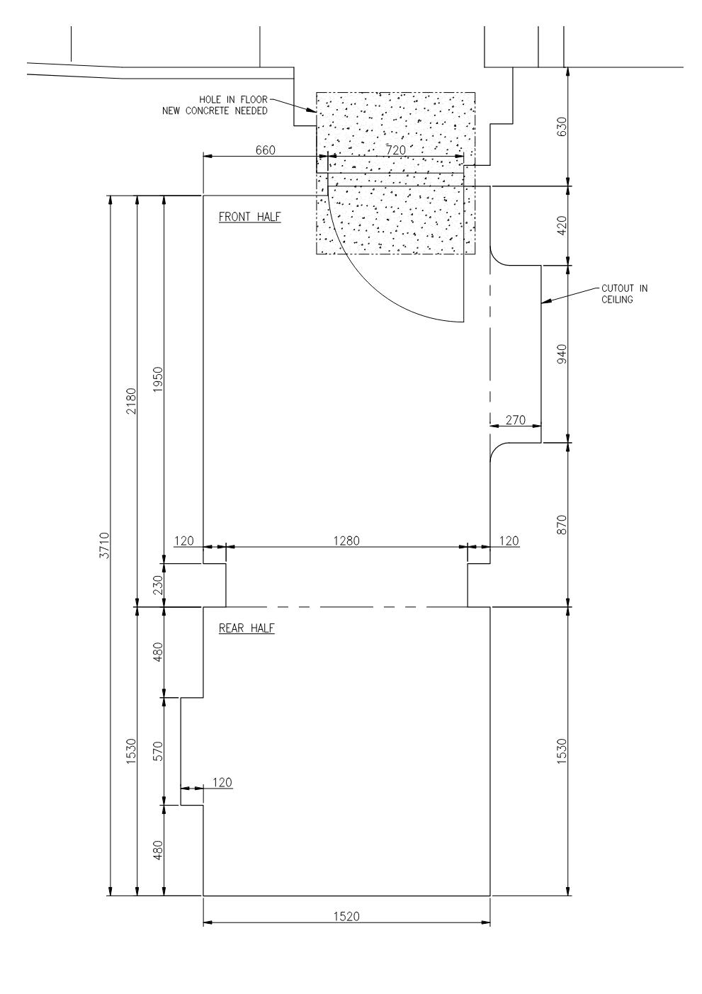

Okay so I’ve been able to get some relatively accurate dimensions for the Cave. I added it to the CAD .dwg plot plan of the space and created a PDF of just the Cave with dimensions so people can use it as a reference for planning out how to use the space. Jpeg version also included below, not sure which will work best.
Few things of note:
The Cave can be split in to two halves, simply named the front and rear. The front half as a solid ceiling (its the buildings main staircase) that is 2m from the floor.

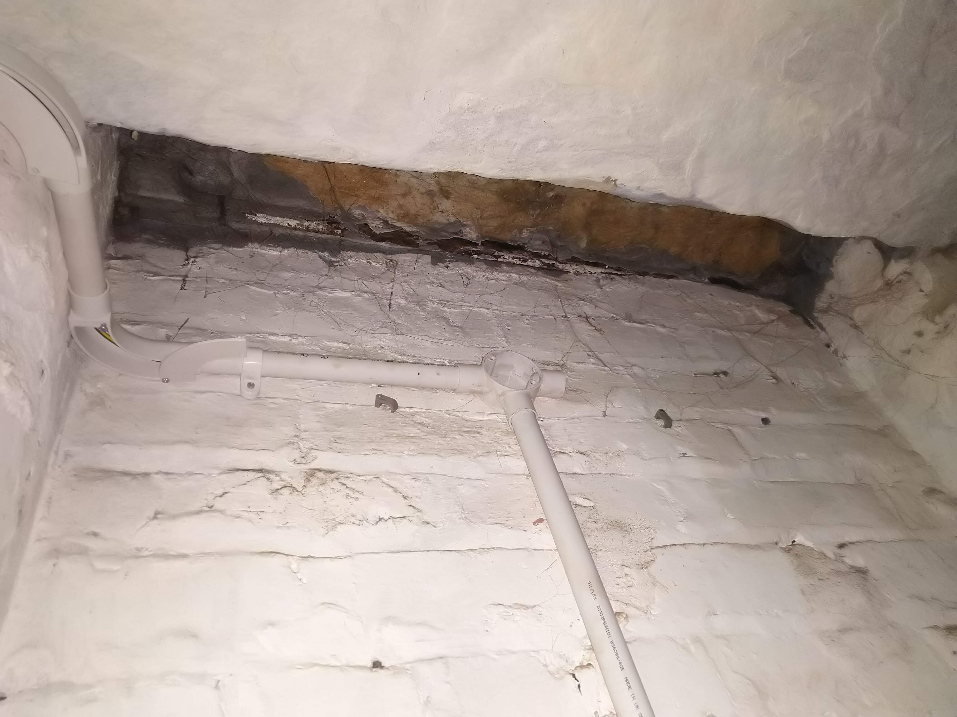

The rear half has an open ceiling that extends up the building a couple floors. It is possible to see the toilet plumbing from the floors above, as well as a some large metal ducting. This ducting dips slightly into the rear half which making the lowest point 1.9m above the floor. Unsure what this ducting does but its heavy and I couldn’t ‘nudge’ it on my own.

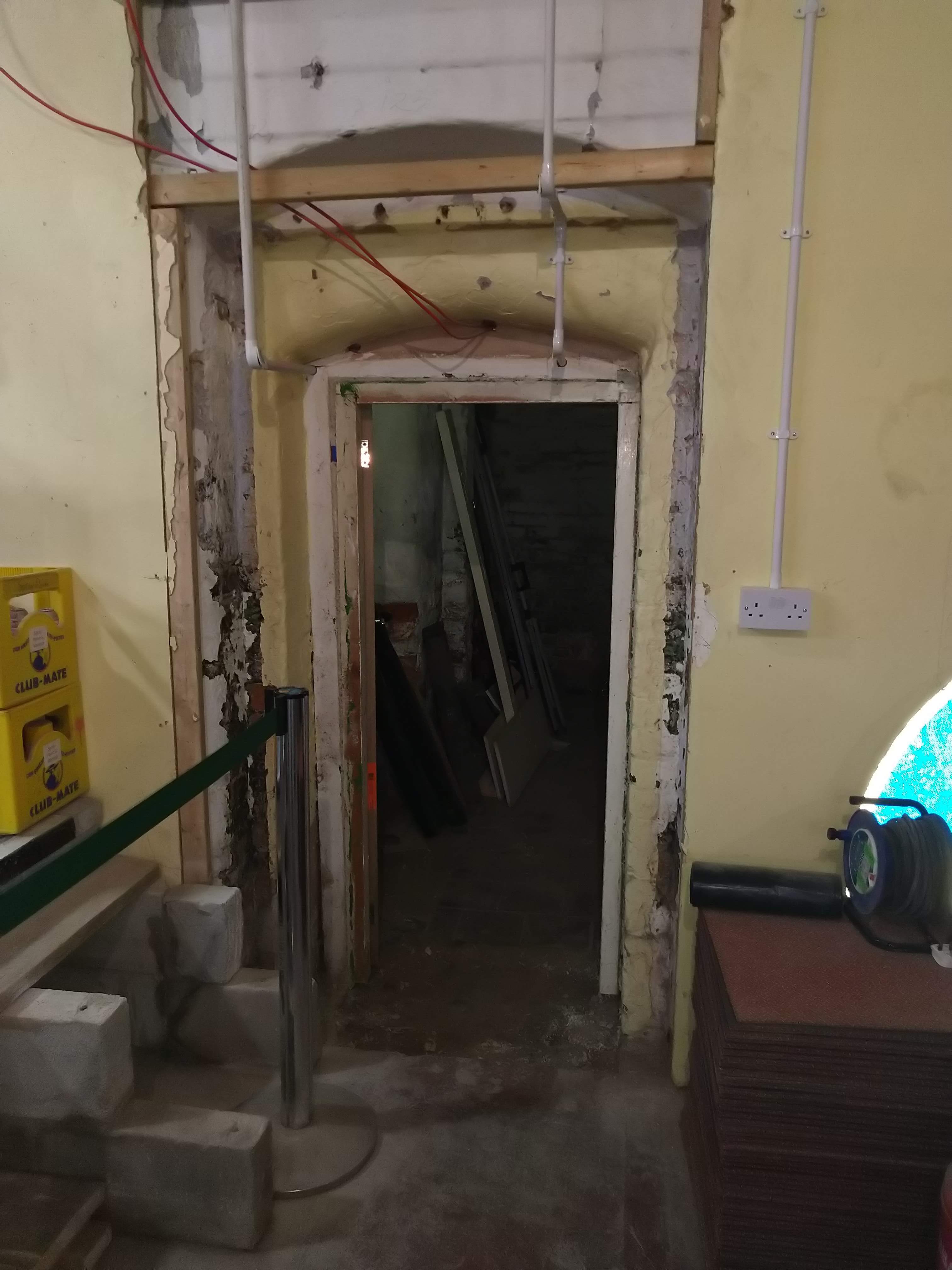

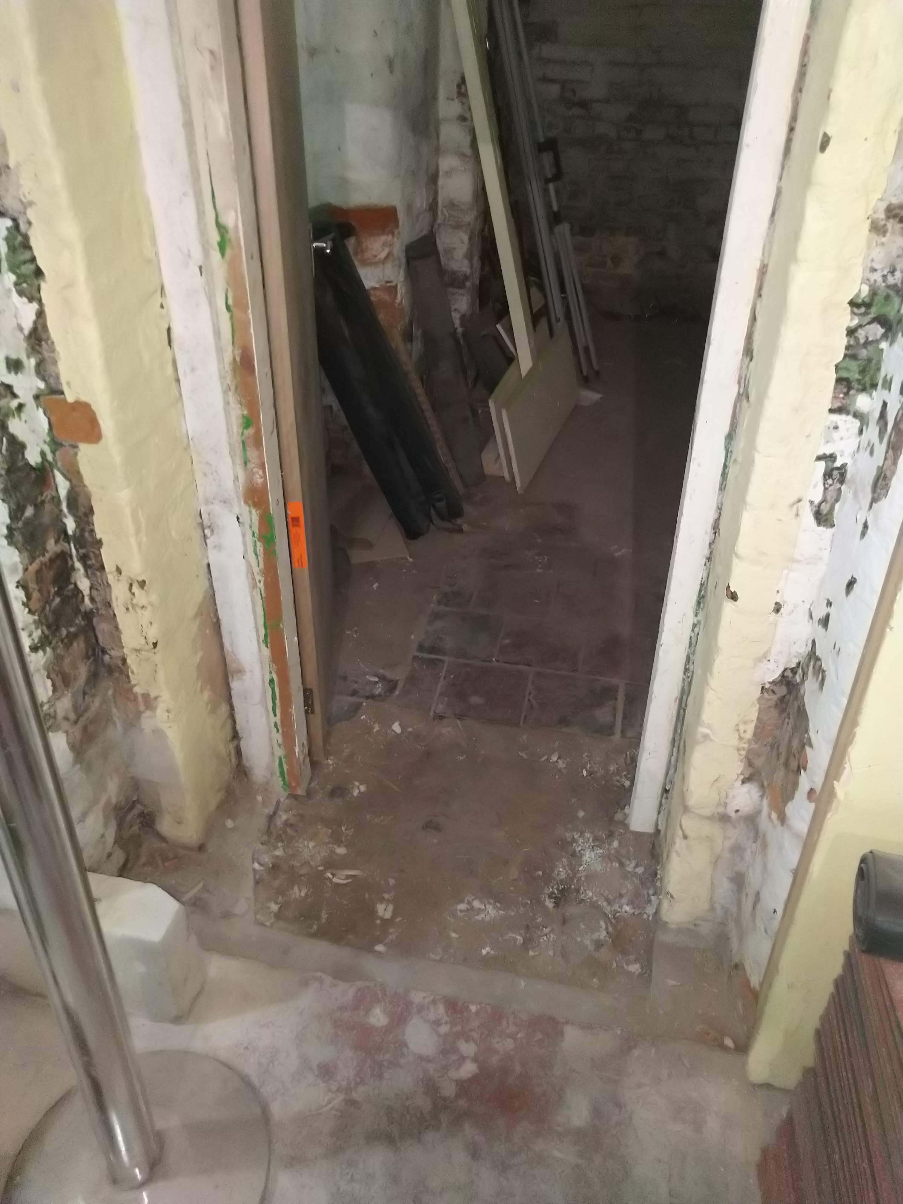

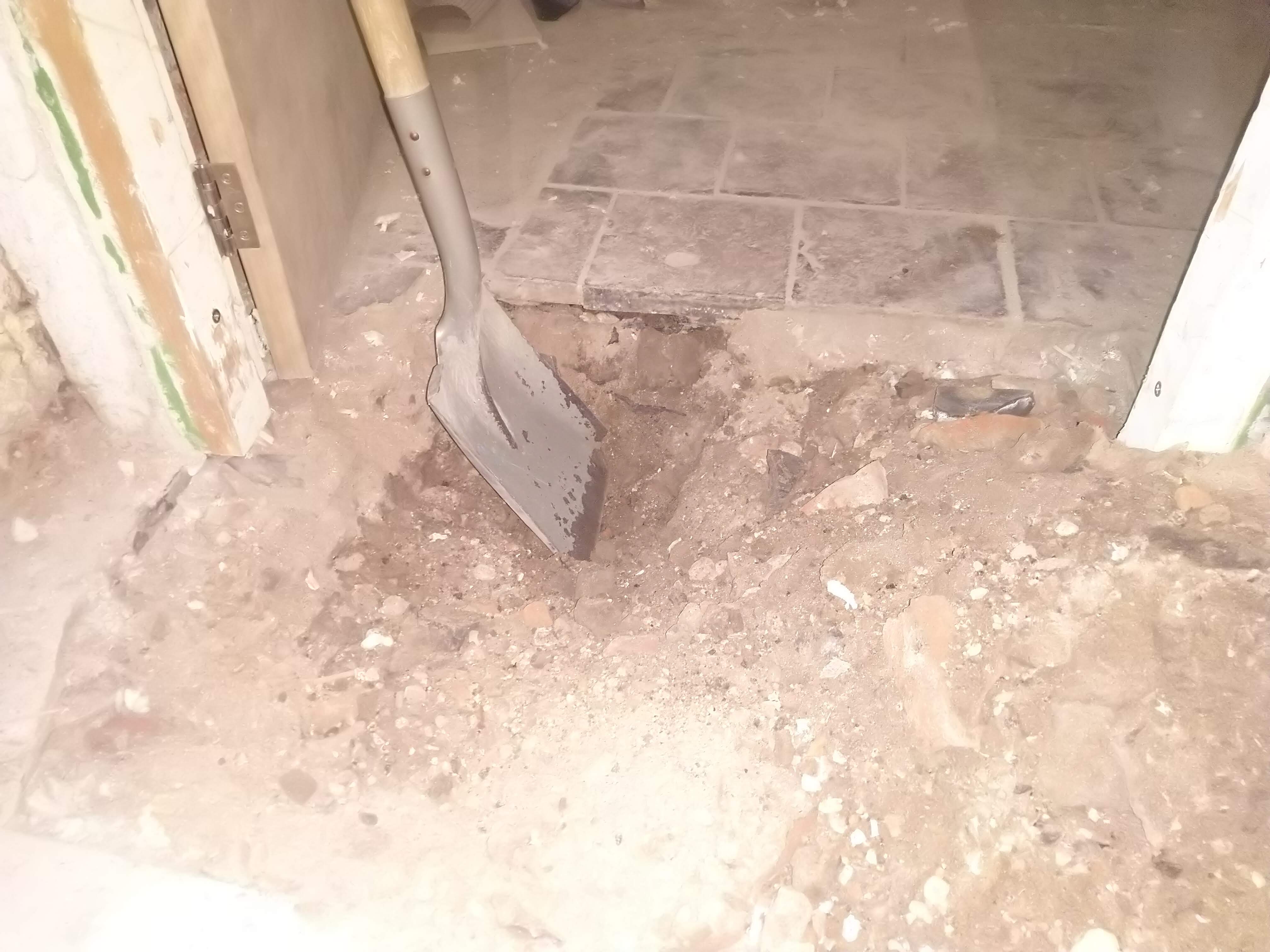

The entrance to the cave has a hole in the concrete that is currently filled in with dirt and rubble. This will need filling in with fresh concrete though to ensure its solid a bit of the dirt and rubble will probably need digging out, it goes quite deep as I think its simply the ground under the main concrete floor of the space. Hoping someone with more experience can weight in on this.

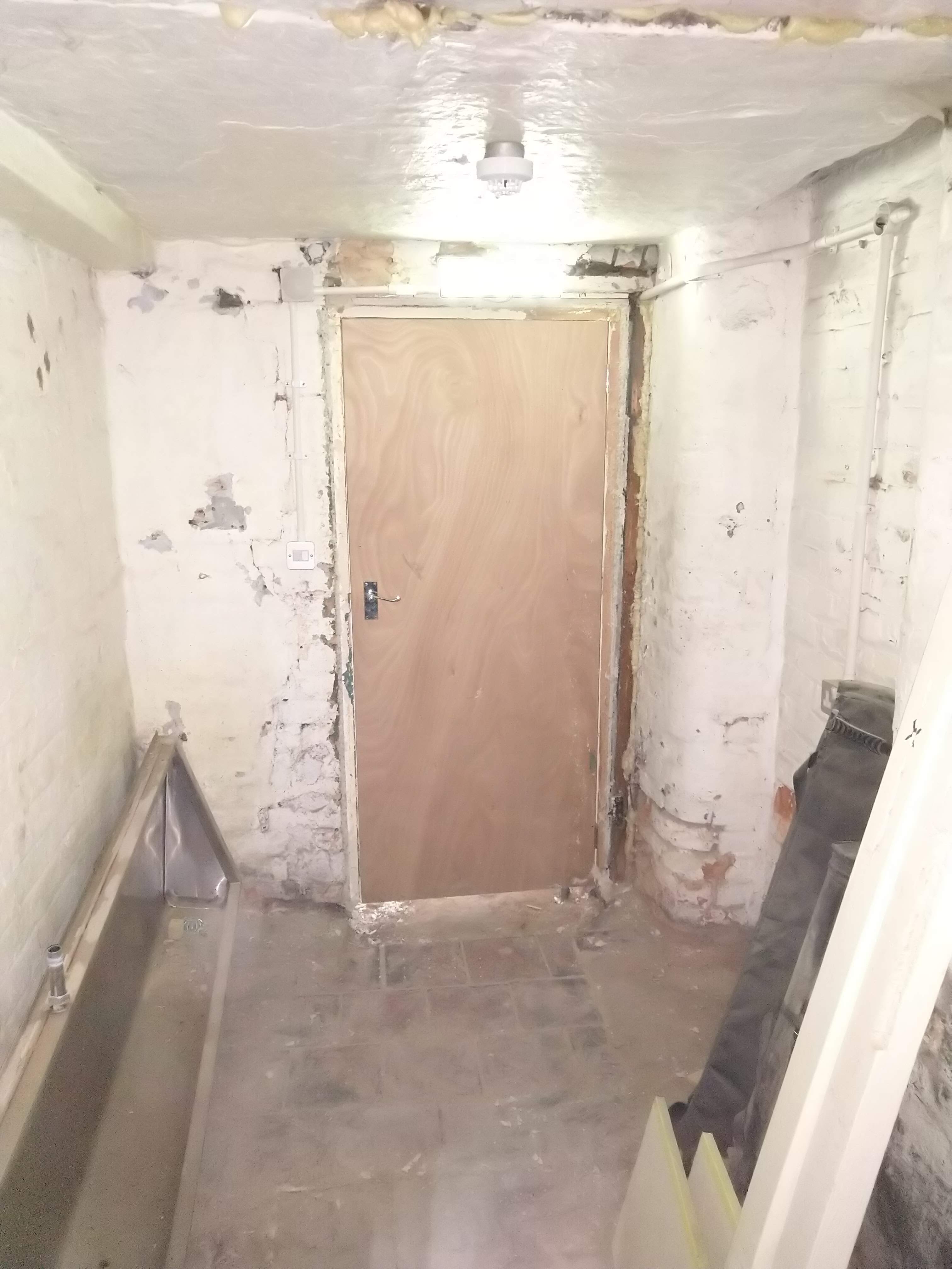

Currently the only lighting in the Cave is by the EM light that is controlled by one of the two switches behind the door on the right. Depending on how the room is going to be used the lighting will be changed to suit. As it can be a bit dark please take care as there is still some stuff living in there. Pictures may look bright but that’s just my camera flash.

bit late to this (sorry Mark) but just to put down in writing that I’m happy to “own” the small concreting job of the doorway. I’m a bit busy with work, so won’t have time for the next 2 weeks I suspect.
If anyone desperately wants to do it, I can talk you through it as it’s a simple enough job requiring minimal tools.

I got some of that reinforcing coil stuff you put in mortars that might help the concrete similar to adding re-bar as well if you need some. https://www.screwfix.com/p/sabrefix-brick-reinforcing-coil-galvanised-dx275-20m-x-112mm/69577
I note there is a step down so whatever we do we will want it sloped. Is the door wide enough for a wheelchair?
If we can’t make it accessible we are probably limited in what we can do.

As you can see on the drawing attached above the doorway is 720mm wide. According to a book I have on these things it lists doors requiring an opening of 32" (813mm) though I’d also note this is dependant on wheelchair designs. I think the harder part will be getting the slope shallow enough so that wheelchair uses can still get back up (yet to see someone get up the VA ramp manually). In addition to this the door height is quite low so raising the floor will make it even shorter which may be uncomfortable for our taller members
As for storage I’m very much against it, but if others think it’ll be beneficial then it wouldn’t take much work to implement. If you’re on about the ducting in the rear of the cave, I have no idea what its connected to, or if it still works, if a member wants to investigate to see if it can be removed I see no issue, but they must not do irreversible damage if it turns out it is still in use.
A quick google suggests that wheelchair slopes should be 1:12. I forgot to measure the step when I was in today, but it must be 4 or 6 inches, meaning the slope would have to be 4 or 6 feet into the room.

I checked the Concrete and that seems to have set now
