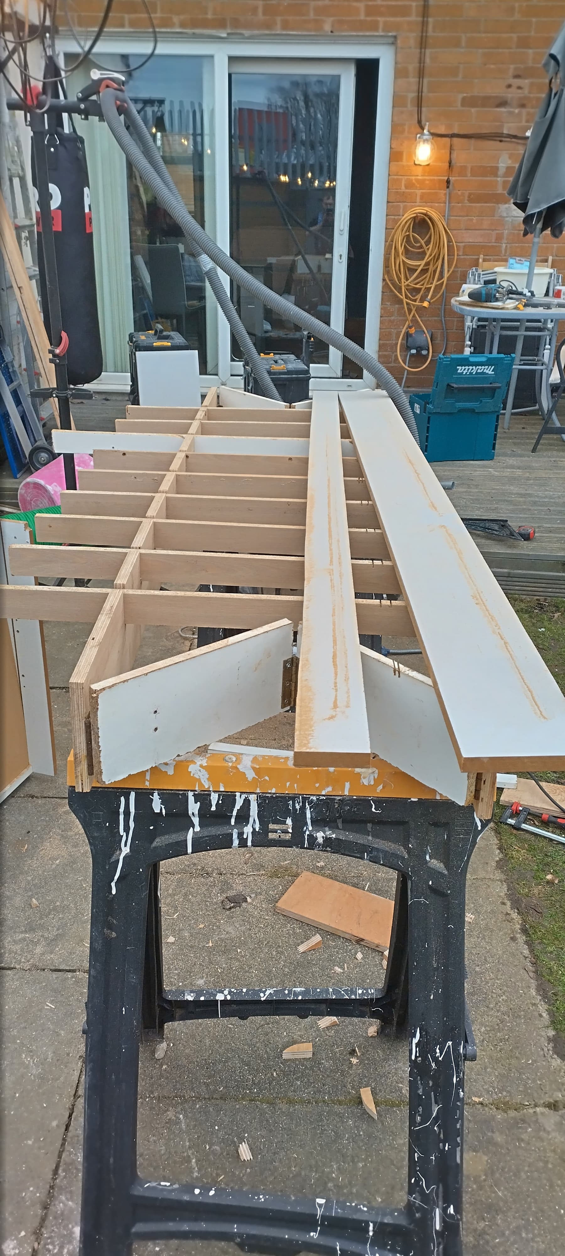

@Josephxtian I’ve constructed a folding surface specifically for this type of cutting and will be bringing it to the space before the weekend (I’m making two, one for personal and one for the space and have completed 1+1/2)

Hey Peter,
Thanks for sorting a cutting surface.
Just leaves the outstanding questions about where they will be stored that they won’t get passively wrecked, and how Inductions might work for it.

As I understand it the saw is likely to jam and cut out rather than seriously injur people if it binds in some wood. So this is more focused on people not cutting through the bench/horse thing you’ve made, by understanding how to use it, and how to set up the tracksaws.
Unsure what the padlock would be around, maybe the track saw and saw horse are chained to the wall or something.
