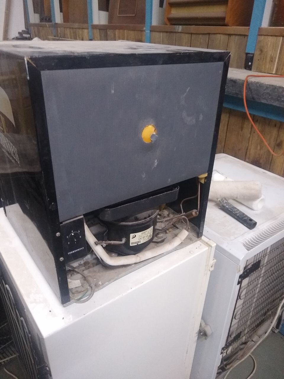

vacume pump reclaime

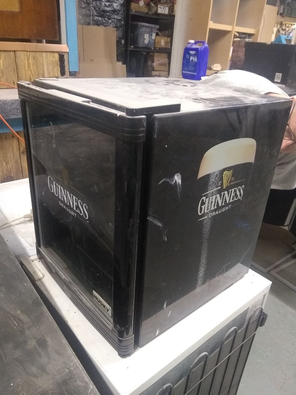

taking the compressor out of this old fridge that no one wants to make a de gassing chamber for resin. its refigrent is safe to de gas as its caming fuel
No objection from me - I think this is the fridge I found abandoned upstairs so it is good to see it get use, if it works!
